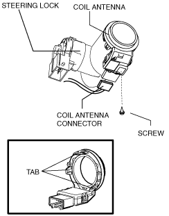

Old Jun 1, 2018 | 05:04 AM
If you get a second hand ignition barrel & switch, get it recoded to your existing key then install it, re-using the existing coil antenna.
Nothing else needs changing or programming. The dealer obviously only wan't to use brand new parts.
