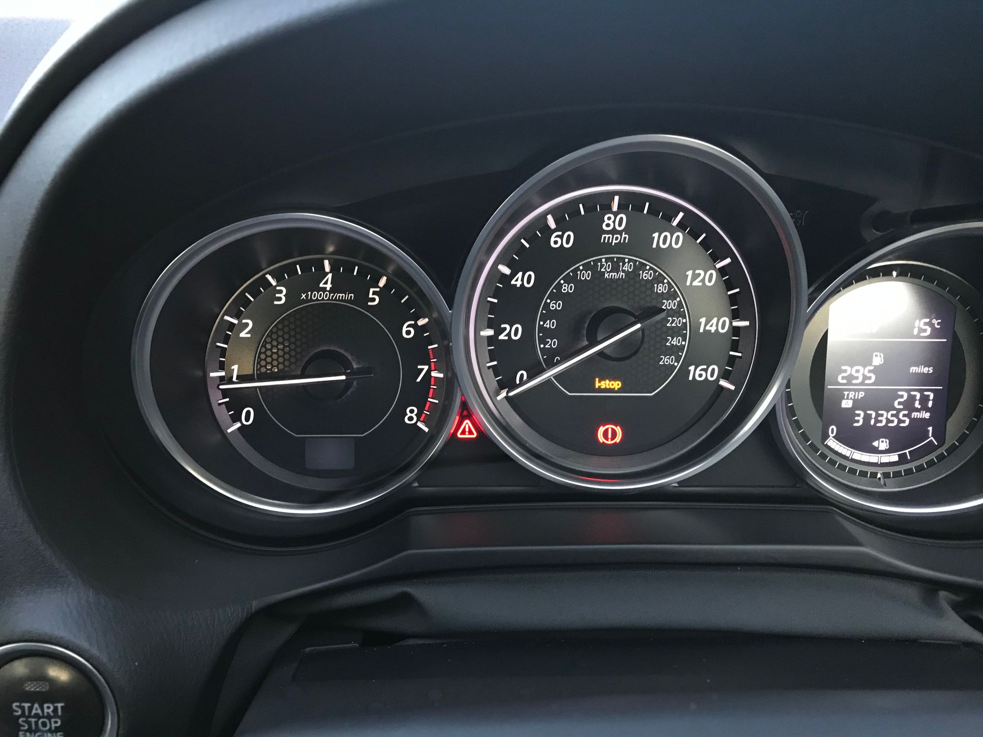

Start car in the morning start blinking i stop amber , and pop up solid Master light , gone after like 5 min but make me scared buy car 3 weeks ago..

Check the battery at Halford , guys said battery in good condition... Google my self littlebit and its Master Light Type B. Anyone have that pop up
Old Aug 1, 2020 | 05:38 AM
Get it scanned for fault codes.
I don't know who Halford are, but i-stop batteries require specialised testing equipment. I recommend taking it to Mazda.
With both lights on, either the battery is very low on charge ( low SOC) or it requires replacement.

Just done that call to Mazda book appoitment at Thursday will see , on phone they said , its like 2 batterys car battery and i stop battery , they need to lookinto
