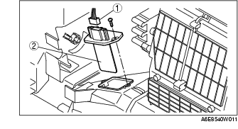

Hi, I have a Mazda 6 sport diesel 2.0, 2006, I can't find the fan control module, could anyone help please
Thanks in advance

Manual A/C or ( Auto) Climate A/C?
If its Auto spec then you are looking for the Power MOS FET.
Pick is for the RHD market. ( LHD should be mirror image?)
Mounted behind the glovebox, between the pollen filter & the main heater assembly.
