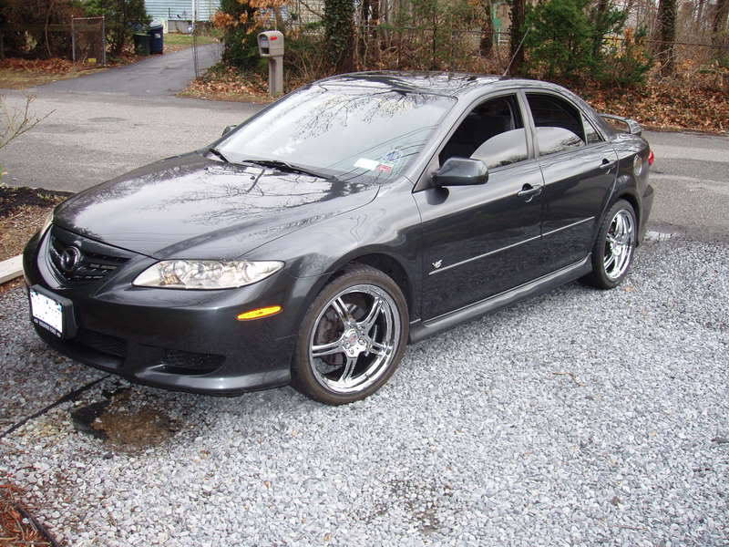

Old Apr 5, 2008 | 04:04 AM
Mazda6kid's Avatar
Joined: Sep 2007
Default RE: Max wheel size
just had these put on 2day MSR 044 18x8 with 235/40ZR18 toyo proxy 4's
