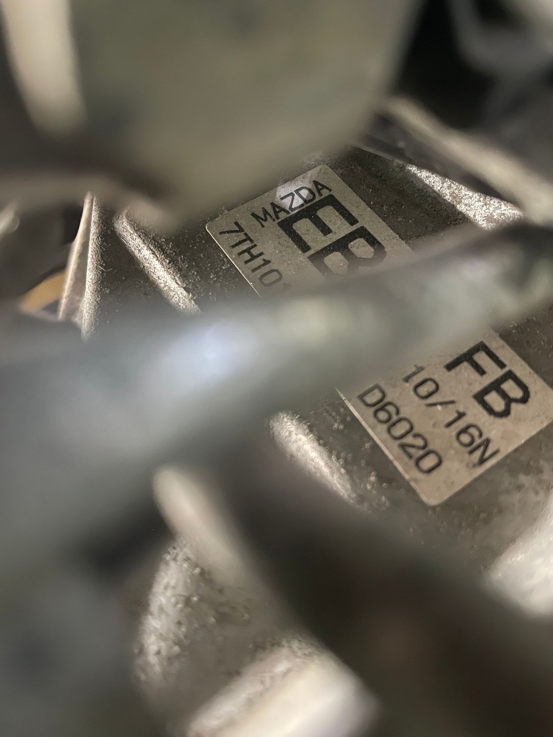

Okay so a gearbox garage confirmed it is teeth (probably) in the gearbox. Which is what I thought.
I'm going to change it myself - does anyone know the differences between the models that attach to the 2.2 diesel?
Mine is EB FB D6020
I have also seen EE FB 6050
I have seen also D6010 and D6040
All are 6 speed manual rated between years 2013 - 2020 etc
Any specialist gearbox advice out there folks? Thanks so far for all your help :-)
This is my code. EB FB D6020

Thanks for the reply They didn't confirm 100%, just told me what they think it is, which considering I only asked for a free diagnostics is all I'll get.
You are right, a listening tool would have helped to confirm the location precisely! Better than my head under the car, and recording the noises on my phone at different places! At some point, I'll need to change parts to fix the noise, and there's so little else that this could be. Even if it's pressure plate or flywheel, it's still box off. And seeing as it isn't related to engine speed I think we have it.
I was confident in my approach though, in terms of holding each wheel while up on stands. If either side is held tight, one at a time, and the noise prevails, and isn't related to engine revolving, but to transmission rotation, then I think we've got our target.
I stripped out the under tray, inspected the whole area, and changed transmission fluid weeks ago for inspection. It didn't reveal anything. I was expecting perhaps a shimmer to the oil, but it was good. Again, if anyone can think of any last minute ideas if this isn't the gearbox I'm all ears, given the details provided above?
I've bought a second hand gearbox as I can't afford a new one £3,100 + VAT.. I have paid £200 for one on about 60K miles.
I matched the gearbox part number with the local Mazda dealership. I'll change the gearbox in about a week and a half and report back!
