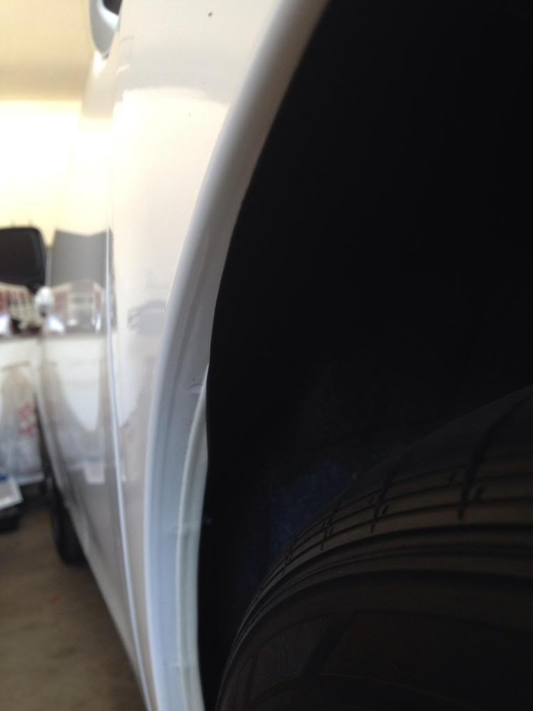

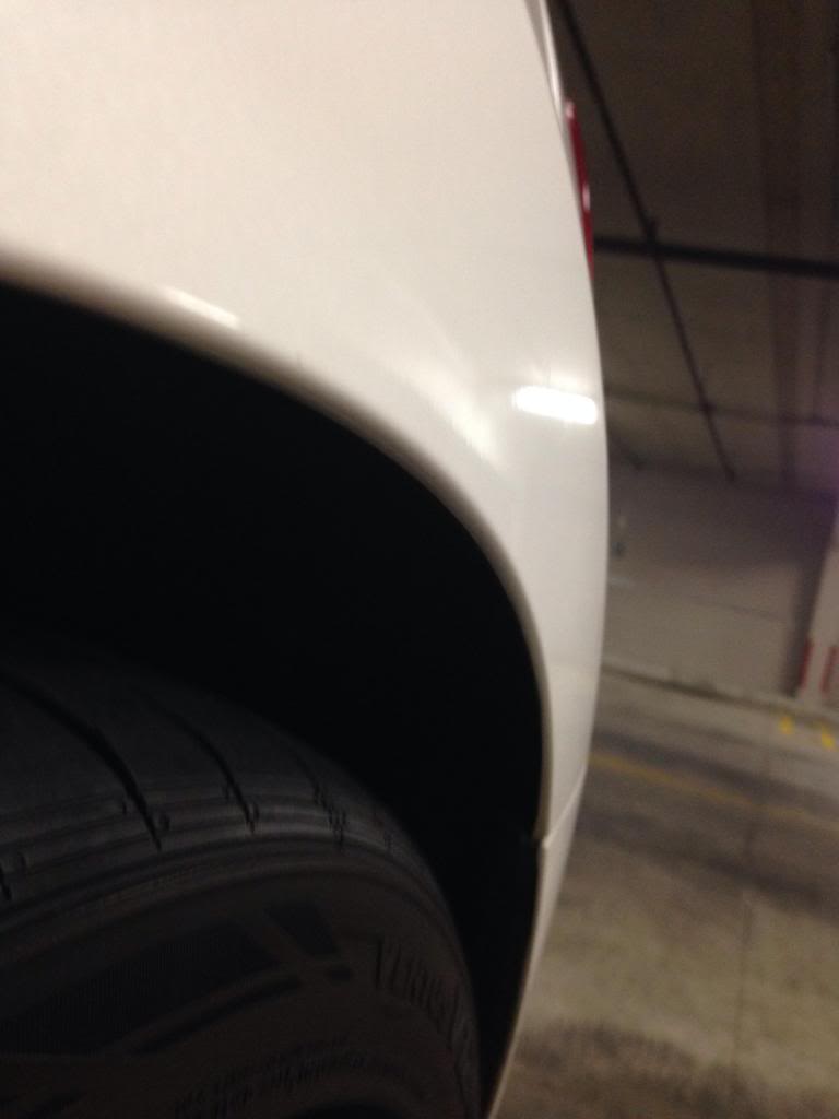

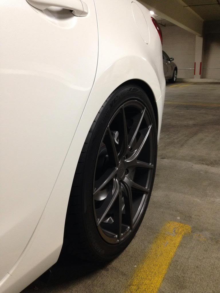

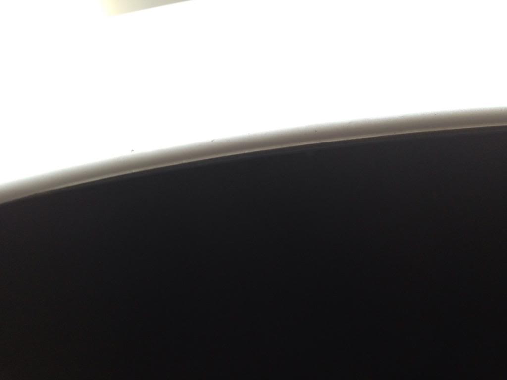

It's been since September '13 since my last mod(exhaust) and after a year of enjoying the stock height, the lowering bug finally bit me! It all started last month when I tried to roll my own fender using an Eastwood fender finisher...now I know why they call it a fender finisher After putting a welt in the driver rear fender, I decided to get my fender professionally rolled. I went to my local detail place and called a few painless dent removers and they all said I had to live with the dent I didn't give up...a heat gun and 2 cans of condensed air, you can barely even find the once 3 inch crease on the fender...it worked! After hours of searching the interwebs...I came across Tony. His name was mention by so many people in the car community that I called. Tony is Fender Rolled by Tony in Granada Hills, CA. I made an appointment last Thursday and in 1 hour, Tony advised on a fender shave because I DID NOT want to pull my fender or stretch it out. A professional hub mounted roller uses pressure ti roll the fender and it pushes it out a bit. Tony has been doing this for years and has done thousands(no joke) of cars. I almost fainted when he to a cutting wheel to my fender but he was precise and he knew exactly where to cut, how much to leave, and what to cut out. Pm me if you want his number. Thank you, Tony, you are the man!

Tony took 30 minutes on each side, 1 clean cut, no measurements or marking, sanded to a fine OEM finish and feel, and symmetrical on both sides...impressive!

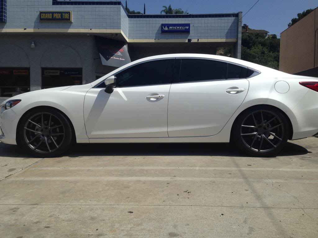

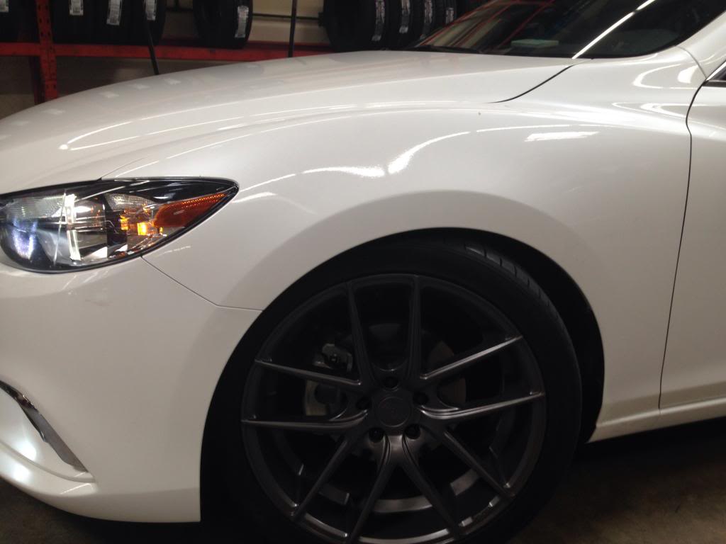

I ordered H&R springs on Friday from Grand Prix Tires in Monterey Park and made an appointment for Monday for install and alignment.
Right off the rack!
After 30 minutes of hard driving before heading into the alignment rack.

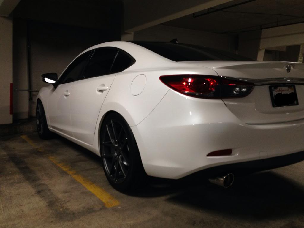

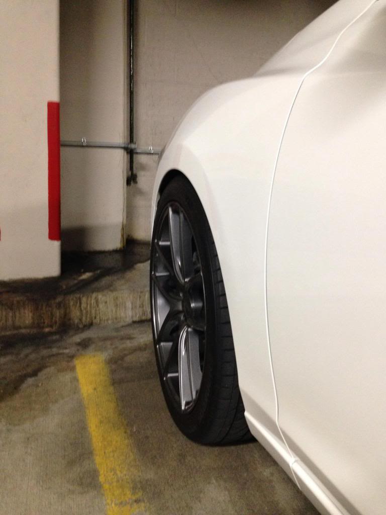

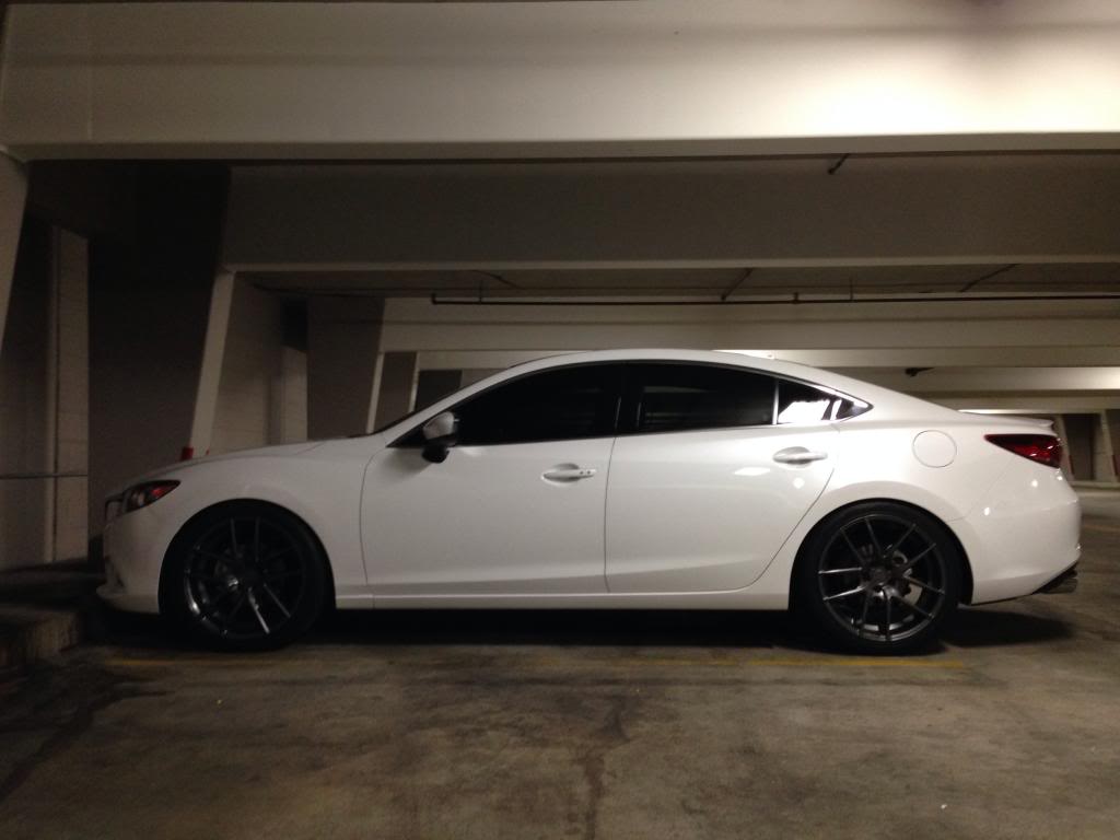

I love the H&R drop of 1.2 front and 1.3 rear with the 245/40/20 tires. It's a perfect gap fill and a good fit all around. If i didn't shave the fender, it would have never fit. The ride feels the same with a little stiffness. I often read "bouncy" but I think the word should be firm. Bouncy would be like my old car which I cut the springs a coil and a half, that car bounced on straight roads, so this is NOT bouncy...just firm. My only regret is that I should have done it sooner.
