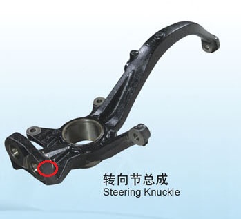

Thanks. You mean hit the steering knuckle edge in the area I've circled in the attached picture? The heaviest hammer I have access to is 4 pounds. Is that suitable? It would be awesome if I can get it off with just that

Hi, yes that's exactly the correct area to hit. That hammer should be more than suitable. Just hit the area closest to each ball joint. And keep trying to lift the ball joint up after every blow. Sometimes the joint can separate and you don't realise it. Good luck!! I've done hundreds using this method.
