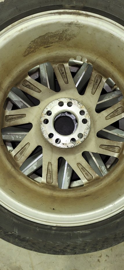

Ok, so after a long day of working to get the rack and pinion out (still have to lower some subframe bolts to get clearance), I got some numbers. And some photos. Here are some numbers: ND-1 2250 17x7.5J, and M115 ET40. Does that help at all? I understand the 17x7.5 (I think) but the rest is foreign to me. I also have a couple photos (also with imgur link for better zooming): https://imgur.com/a/cJQoSD1

M115 is the models numbers so it's an MKW M115 rim. The offset is 40 on a 7.5 inch wide rim which pushed the rim/tire outward towards the fender by approx. 25 mm. Check and see if it rubbed anywhere. If not, then check your existing clearance and you may be able to put wider tires on this rim but watch your diameter and try to not go more than 3% larger. Remember wider tire will be into the fender more.
​​​​​some of your model year came with 16x6.5 with 52.5 offset. That would be a more ideal setup and allow you to put tires with more sidewall on. Or if you find a mazda rim with 16x7 inch with 45 offset that may allow you to also use slightly wider/larger tires as well and greater sidewall. If it's currently got 205, try to stay as close as possible to OEM and not to go wider than 215 preferably or 225 max.
