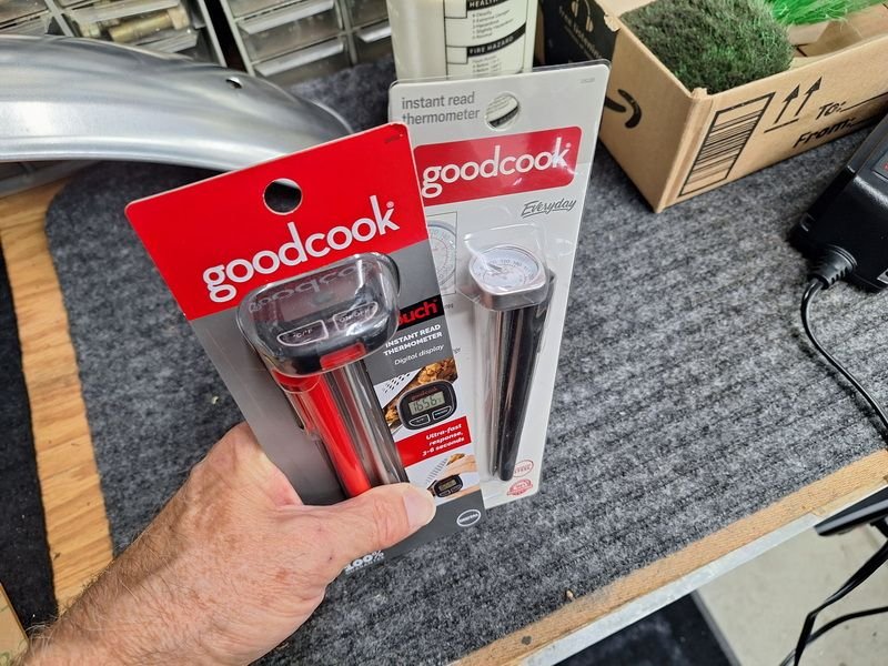

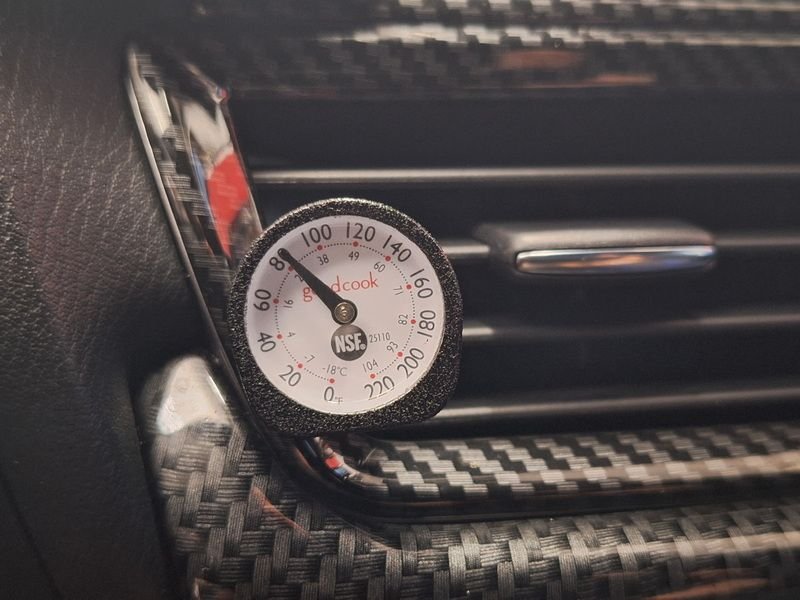

I would like to know that actual temperatures you register in the vent area's of the different setting ? A hand held Digital Thermal meter is great for that. Or if you don't have one or want to invest in a very useful tool a kitchen temperature gauge works great. Not hyper accurate but close enough.
I actually paint pone of them and use it always in my top vents in many of my vehicles. Also a couple of places in the engine compartment.
