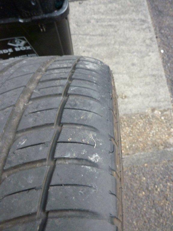

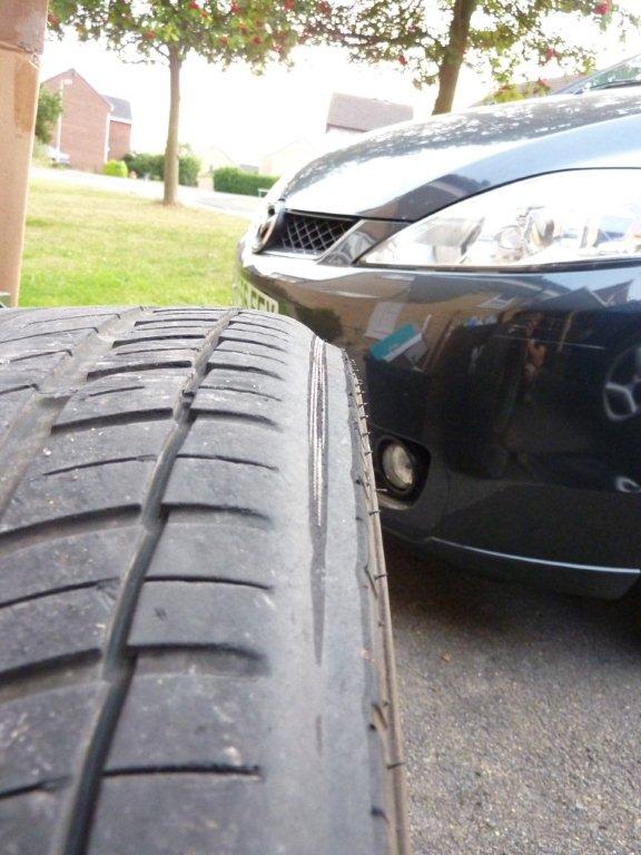

Hi, as reported a few posts ago, my regular service reported worn bushes on the front lower arms. The garage warned me that tyre wear was excessive, which i just put down to the Mazda5, however was shocked when i felt around the back of one part of the tyre, then took the offending wheel off. See attached. The tyre actually goes concave just before it reaches the shoulder. :O
About 30cm of the tyre inside edge is down to the wires, but most of the tyre is like you'd expect for this car. The second photo shows the wear, where the tyre used to be on the back, but due to low wear there, wass moved to the front about a year ago, so has now served two years or 17k miles service.
If the bushes have caused this very odd tyre wear, then i'll be happy to replace this tyre. Needlesstosay until i get the car fixed and tyre replaced (6 days from now), i'm using the spare at under 50mph.
