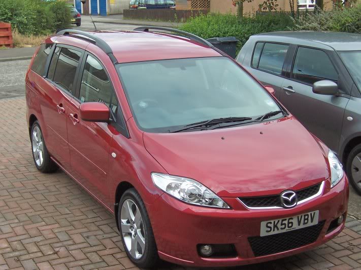

Just found this forum, thread and problem on my own Sept '06 2.0 TD Sport. I have the standard Dunlop SP sport 205/50/17.My rears are wearing, approx 2mm left on the inner edge, but my fronts are goosed at 10k! Wearing in inner (slick) and outer (tread visible but only just)edges, but fine in the middle on the front, inner only at the rear. I took the car to my supplying dealer this am and the technician thatI spoke to commented that this was a known fault and that he thought Mazda replaced the tyres and claimed the money back from the tyre company. A more senior tech then came out, gave me the customer service number for MMUK and said that, again, itwas a known issue and that it was because the tyre's compound was too soft!I've never heard such rubbish. Looking at my own car, it's clear by the naked eye that the camber on all wheels is set to have the wheels away from vertical at rest. Wish me luck. I'll post again on Monday when I have called the lovely Nicole!Name:  Familyto090906147we.jpg

Any chance of resizing the photo - it makes the thread very difficult to read due to the width.

Sorry abut the photo-I thought I had- now sorted.
