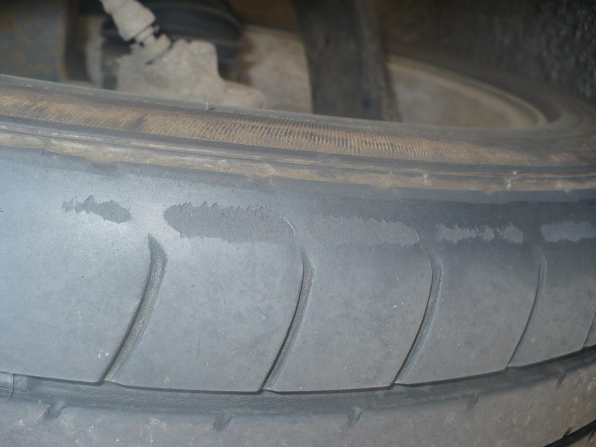

From: Midlands, UK

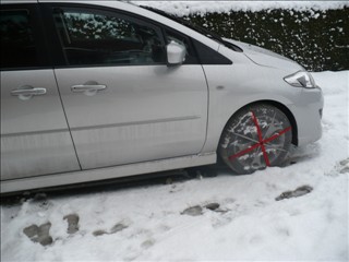

I actually got an artificially high mileage because this last Dunlop pair have spent most of their life on the rear, including a 4000 mile trip around europe in July. They had worn very little, even though performance (grip) is poor. But I put these on the front recently and the inner edges are now smooth but until the ply or cord shows they will not be replaced as Mazda and my 'provider' only look at and measure the centre 3/4 of the tread pattern, which is still currently about 4mm. I know there are tread wear indicators too, but these are only great if our tyres wore nice and evenly. It currently slips all over the place now, even on straight roads if you drive over white lines and overbanding etc. Bearing in mind snowed a bit yesterday and today. I will be putting my autosock back in the car (645 for Mazda 5 sport). Just in case as I will have no grip at all in ice/snow.
If your tyre looks like picture shown, it is an offence with points and fine. Other picture is Autosock just in case you have never seen or heard of it.
http://www.roofbox.co.uk/scripts/rbv...N_TjfU3k2TvXzS
Because I couldn't even get out of my drive yesterday I quickly popped the socks on and it drove out and about without slipping once (max 30mph). Again I'm impressed by the autosock as with earlier this year in Feb when it snowed too then.
By the way the snow picture was from earlier this year, Feb , remember the heavy snow? Yesterdays picture would have been similar.

my tyres and the wear is extremely bad on the fronts and the severest wear is confined to a 1cm wide band. See linked photo - note darker band of wear which is now down to the rubber layer below the tread rubber layer. Everyone else's tyre wear like this? My car has done 12.5K miles
No link in the post but it sounds the same as eveyone else - 12.5k not too bad I got 8.5k out of my 1st set on the front.
