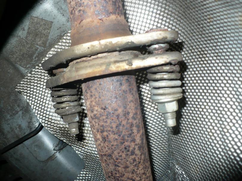

i've got DA-Clunk! too. i thought i'd ran over something. but the sound came from inside the car. So, i'm happy it's a characteristic, as long as it doesn't turn into a character-flaw. Please post more, for those that get the chance to have their cars in the air, and can repeat this noise.

An update on my Mazda 5 2l petrol sport (08). I did put copperslip around the rear spring loaded exhaust joint a few weeks after my first page post. The noise did disappear and has only reoccured a few times now since after all the snow went away the other week. I assume the wet & salt has washed it out a bit. I will re-apply the the grease (only use copperslip or nuclear grade nickle grease because of temperature obviously) to this joint again if the weather if fine tomorrow.
No other noises to report.
You can see the remains of the copper slip at the fitting end of the joint. Its hard to believe the state of this 8 month old exhaust.
