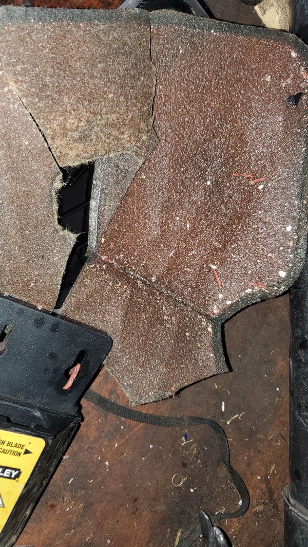

inside of filter. Finally dug in to do a complete trans svc..5 qts oil.and filter. Orange tacky sealant ( factory?) was a bearcat to break the pan from trans. I got it started with a razor blade then gently used a small screwdriver to hold tension while working around the pan with razor blade till it came off. Looks to be the same as sealant thats on trans in other areas. Seems to be shifting better and happier. Time will tell. THANKS TO ALL
Callisto youve been invaluable !
Did you mention mileage on vehicle? Please update results as time/mileage advances, for all to learn from? Interesting progression and I have never seen a trans filter that looked like that!

UPDATE. Today the car ,I believe, went into fail mode. Transmission light, gear selection lighr went out. Would not operete in manual mode and seemed to be starting from a dead stop in 3rd. AT , check engine light on . UO101 code has been setting all week repeatedly. Some times it chrck engine light would go out and other times it was on for a day. I believe the TCM has left the building. Manual mode does not seem to cause the issues but ??? Has anyone used UPFIX to refurb their module ?
Cheers
Thanks for the update. Sorry for the issue. Do you think exposure to heat/water had anything to do with the likely cause?
Sorry I have zero experience with any re-builders, can't help there at all.
