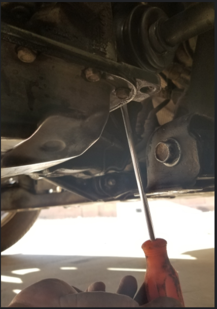

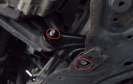

In the first video at 8:47 is one way of prying the transmission forward. They are removing the passenger side, but that will work also if you are removing the bolt from the driver side.
In my case I removed the bolt of the rear mount (either of these bolts really)
And then I used a 15inch flat pry bar ($4 at Harbor F). I placed the flat end up against the transmission and leveraged it on the LCA mounting frame and just pushed the edge of the transmission. This swings the tranny towards the front of the car, just enough to pull out the bolt, Careful not to get your fingers pinched. I don't have a pic with the pry bar but here's a pic with a screwdriver instead of a pry bar just to give an idea of how to position the bar. Hope this helps.
