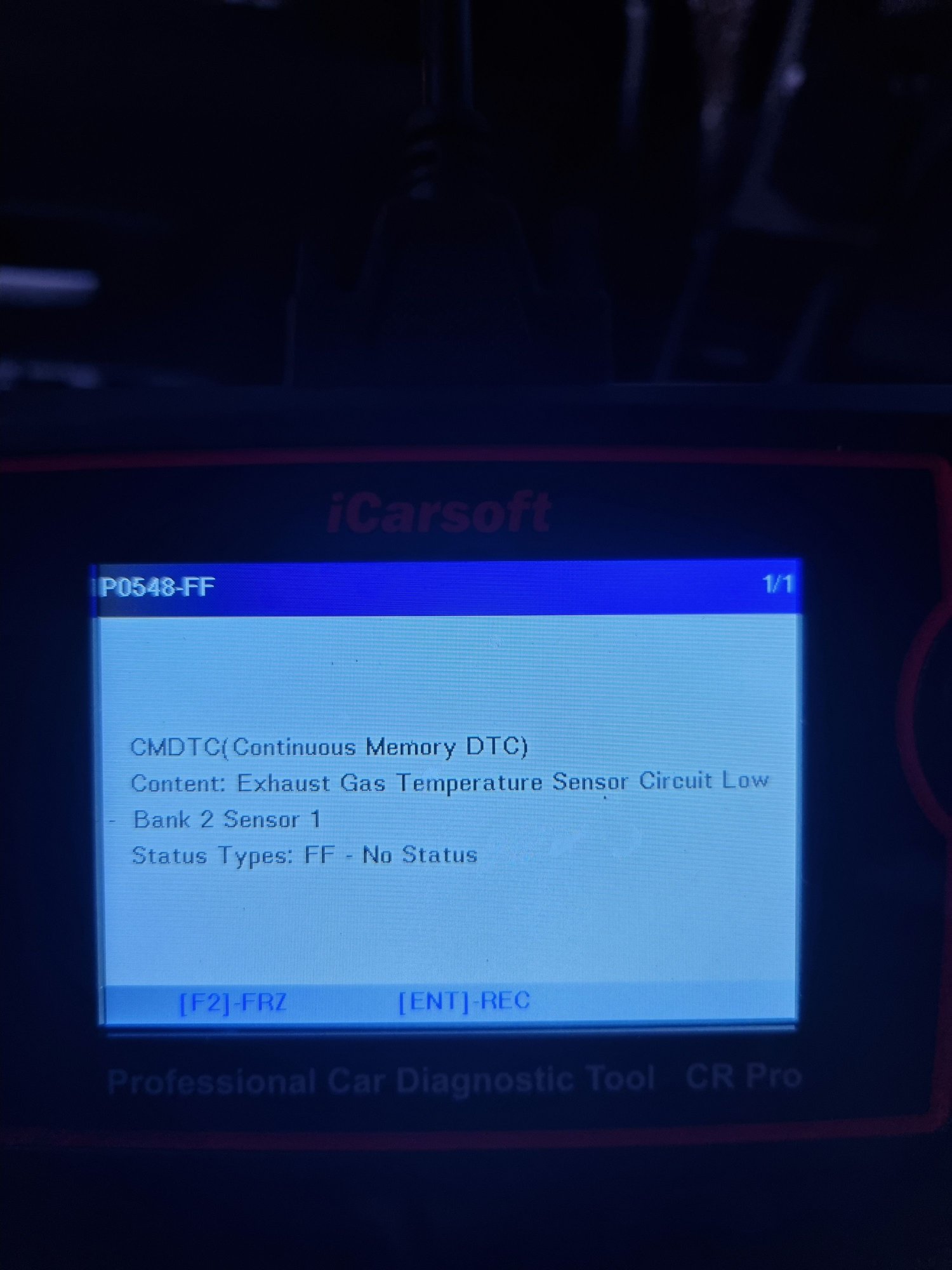

I pulled the codes and got:
Powertrain - P0548-FF - Exhaust Gas Temperature Sensor Circuit Low, Bank 2 Sensor 1.
ABS - U2023-A0 - Fault Received From External Node.
Air temperature - B1261-FF - Sun Load Sensor Short Circuit To Ground.

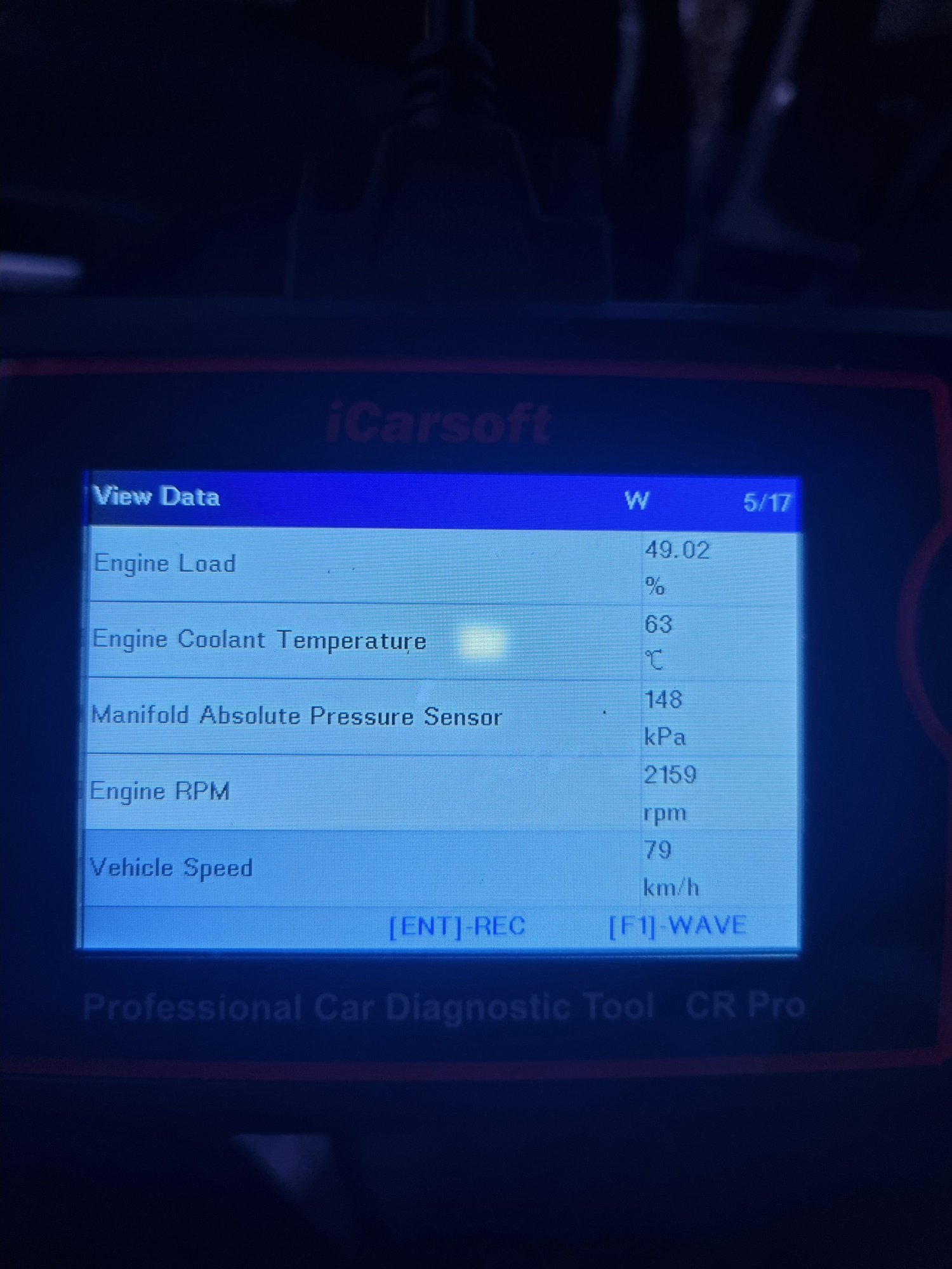

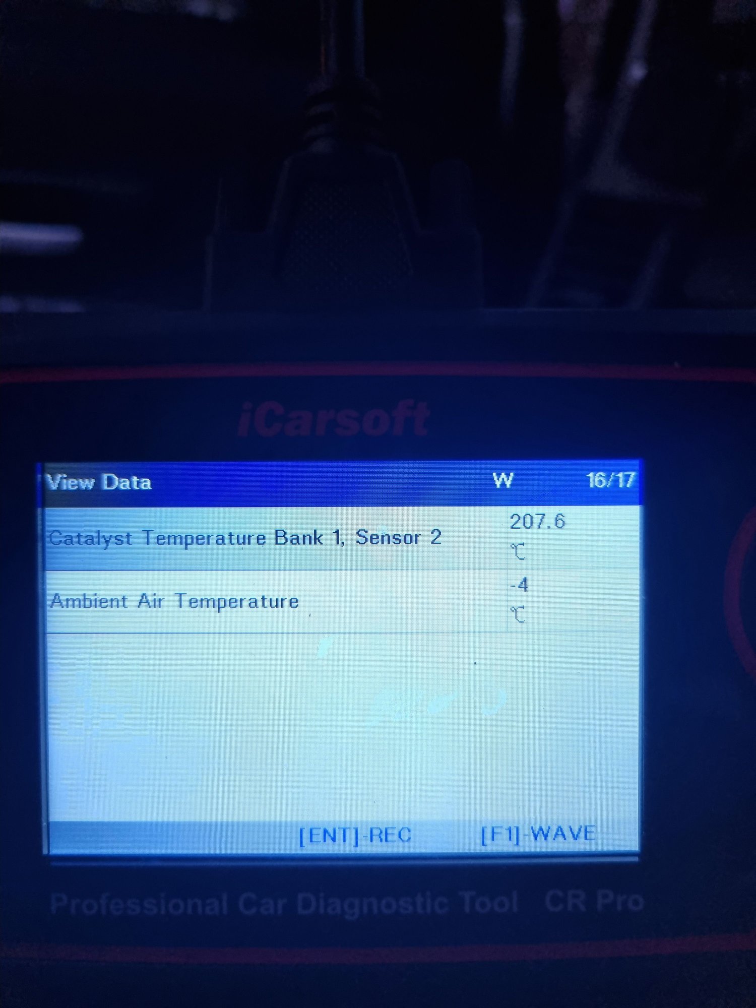

I took the freeze frame data for the P0548 code, i will attach everything to the post. Perhaps someone with more knwoledge than me can make something out of it.
I would appreciate any advice! Normally i would just change the lambda sensor and be done with it, but since the TCS/DCS light comes on at the same time I get a bit baffles. Doesnt make any sence to me, those systems should be unrelated - right?
Any ways, long post, thank you for hanging on and like i said - i will update this post regularly with what i do and the results.
Cheers / Ola (sweHNTR)
Freezeframe data for the o2 sensor code
