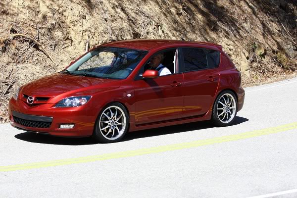

I have 18X7.5 48mm offset wheels with 225/40 18 tires on mine, and it is lowered 1.5 inch in the front and 1 inch in the back
