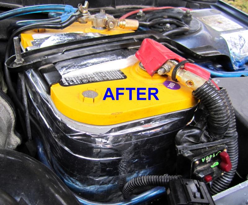

A couple things to remeber when installing another amp like Current draw. Don't go to big, or alternators and batteries may be changed more frequently.
Please install another ground wire from the body of the car to the negative terminal at the battery. Most people just ground the amp at the back and forget the front! Ground at front can be near battery. Also, install another ground wire from the engine block to the negative terminal of battery.
Also for proper safety: A fuse should be located near the front of the battery on your power wire (or a circuit breaker). Most people put an amp nearer to the rear of the car. If you get "T-Boned" (hit from the side) and a cut happens in your power wire going down the side of the car, it could start a fire as it is directly hooked up to the battery.

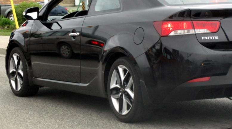

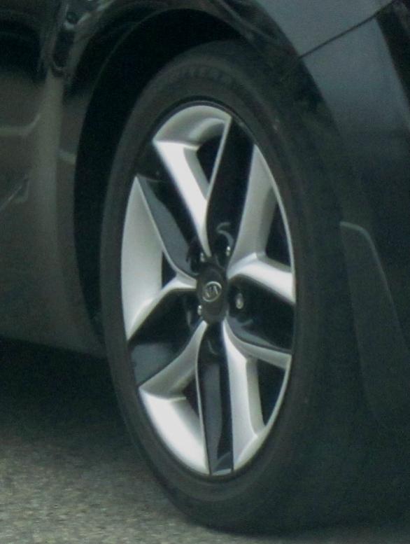

Saw some decent rims today while driving. Took these pics at a stop light thru my windshield. The color placements should be reversed. I think the black should be where the grey is.
Attached Thumbnails Opinion on wheel upgrade-rims1.jpg   Opinion on wheel upgrade-rim2.jpg
