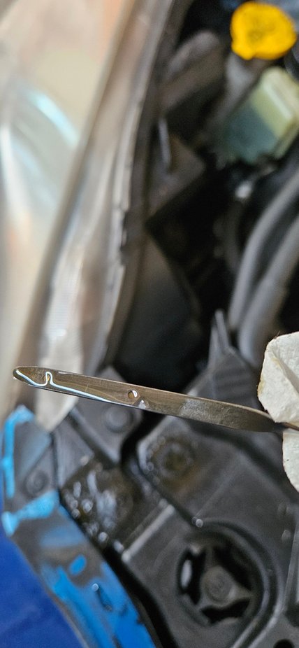

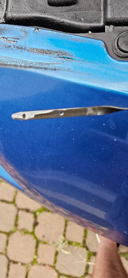

I just picked up my 2013 Mazda 3 after an oil change. It has 200,000km on it. However when I checked it in my driveway, is overfilled by about 0.5 quarts orvso.. Pics attached
I know overfilling an engine is bad, so should I be worried about this much?
Thanks

Well yes and no….
Did you wait a full 24 hours or overnight and check it before starting the engine.
I also see sign that the dip stick was not wiped with a paper towel? Not that I want to get into great debate but paper tolwes most often clean the dipstick better than a rag.
If after you reconfirmed the oil level as I suggested and it is that full it would be a better idea to remove a small amount for peace of mind .
Before you or others start jumping the gun and panicking your engine has a balance shaft assembly and it takes just over a full qt from the top mark on the dipstick to fill the sump close to the oil pan flange . That’s all I will say for now about that.
Hot engine @175f oil temperature and just shut it off about 10 minutes ago. Last oil change took exactly 5 qts from a drained engine of 45 minutes or more before new oil filter and oil.

Makes sense.... Maybe it wasn't fully drained?
So I checked it this AM when sitting overnight. It looks just a hair less than my other pics and compared to your pic of the dipstick, a little more than your level..
I guess the question is is that ok or does some need to come out. I'll have to take it back to Mazda if that is the case..
Thanks again for your advice

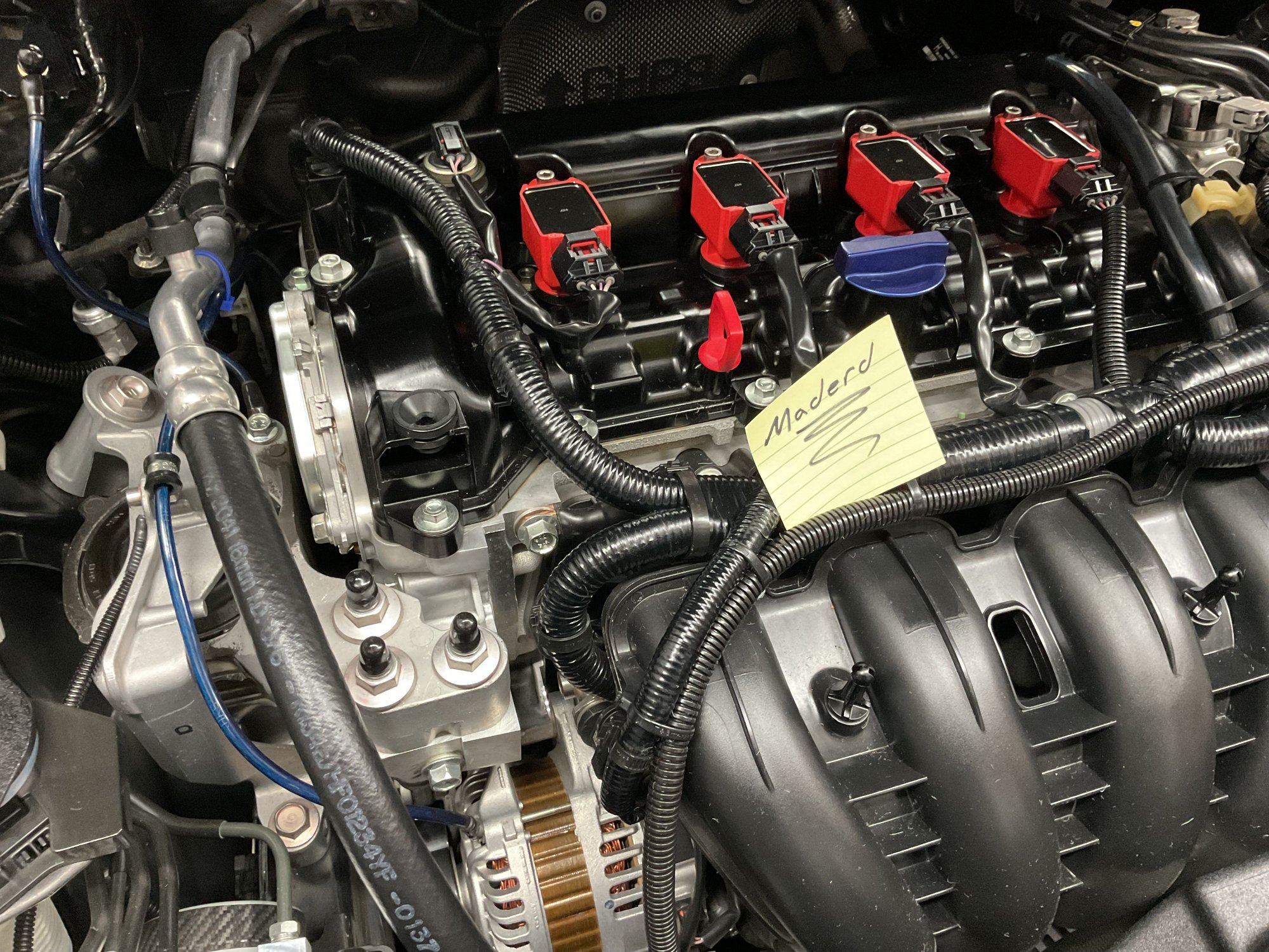

Overnight sitting completely cooled off. This early morning before my coffee...lol

Much appreciated for those pics Yeah based on that mine is about 3 or 4x more above the upper hole than yours this morning... For my sanity I'm going to get them to drain some out lol
