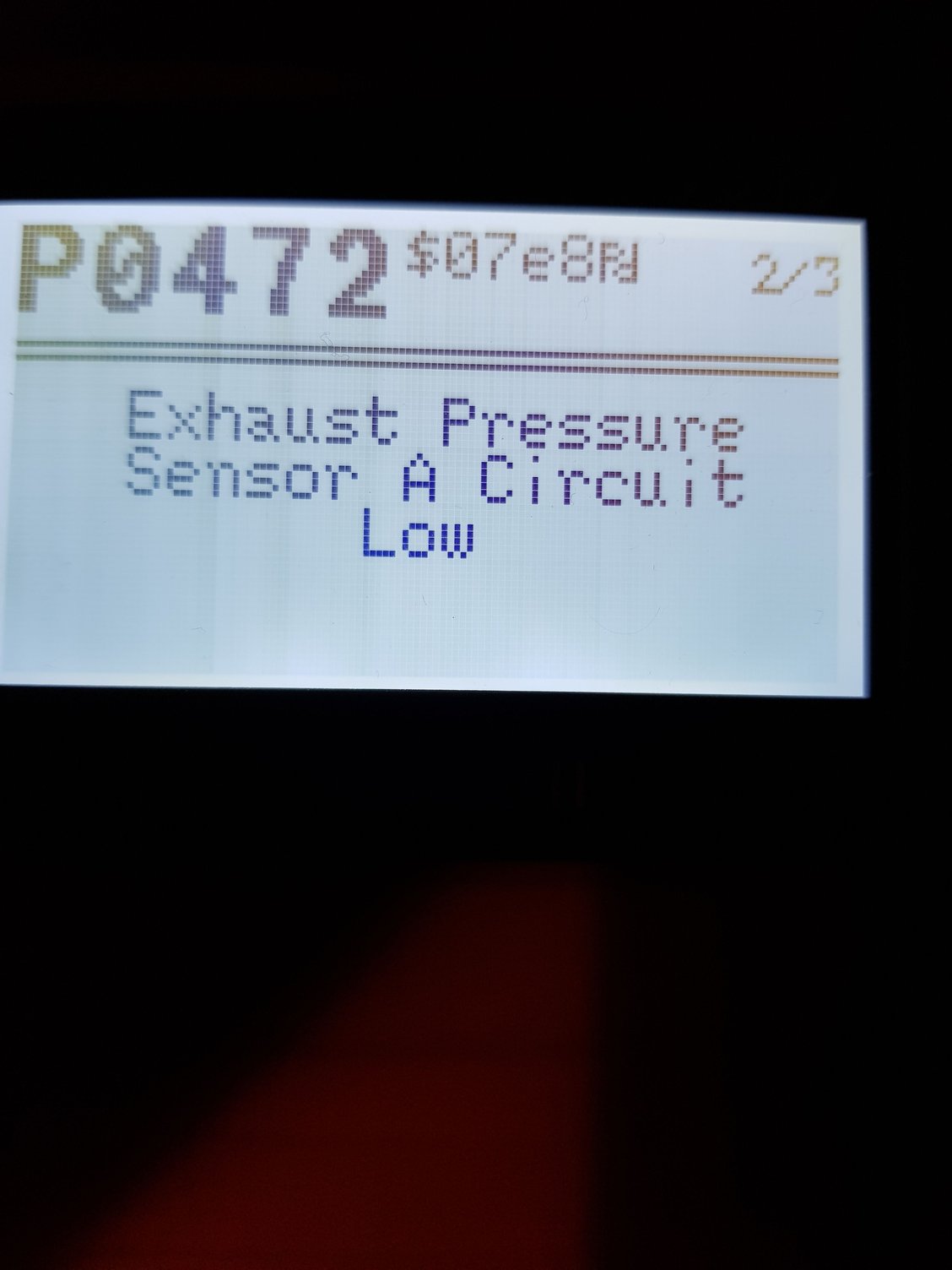

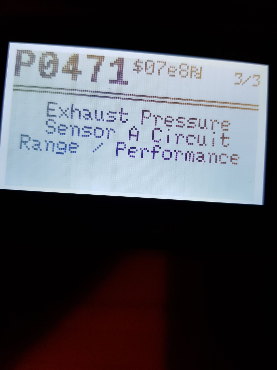

That sensor is definitely very old and a very old version, later versions had coloured dots, followed by a orange moulded cap, followed by a solid steel modified sensor ( kit #SHY6-18-W00 )
Both of your codes relate to the exhaust pressure sensor, you will need to replace it with part #SHY6-18-W00
Picture of new sensor, courtesy of google images https://www.fox.rzeszow.pl/czujnik-c...,305636,305635
The two pipes you speak of are for monitoring pressure difference in the DPF.
Also, when did you vehicle last go to Mazda for a PCM/ECU software update? These motors need up to date software for efficient running.
