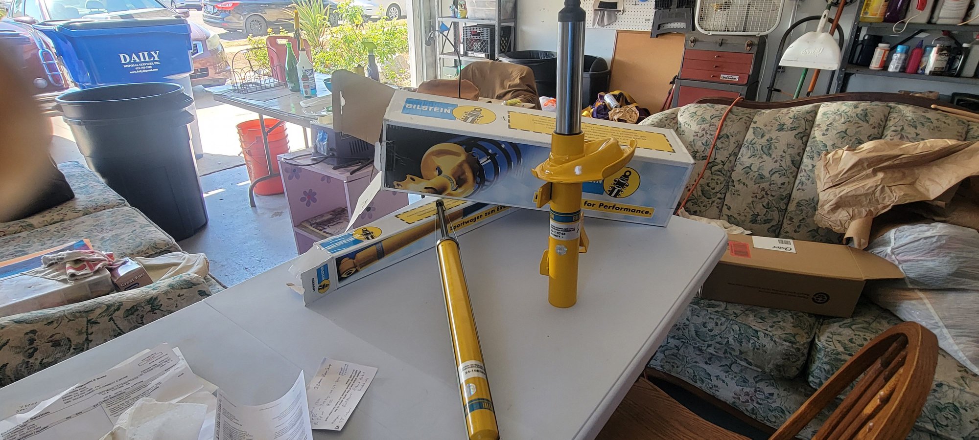

I recently bought a 2012 Mazda 3 Grand Touring Sedan (skyactive) with 77,000 miles. I had never driven a Mazda before, I really like the car.
I decided although the stock struts and shocks, springs (2 new tie rods installed by dealer who sold me it) were fine i am having new Bilstein B-6 Performance Struts (Part no.35-110736 / 32-110743) $211.00 each and Rear Bilstein shocks (24-196529).$99.00 each . And also swithching out to Whiteline sway bars.
$440.00
Labor is about a grand-
Work gets done in two days - yeah !...... looking forward to seeing extent of improvement.
For 2012 Mazda 3 Grand Touring Sedan - sky coils are fine, I am not lowering the car but now would be the time if I was going to.
