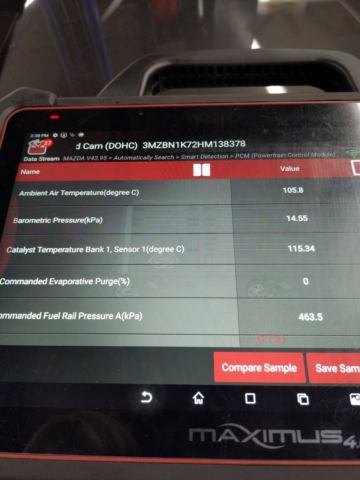

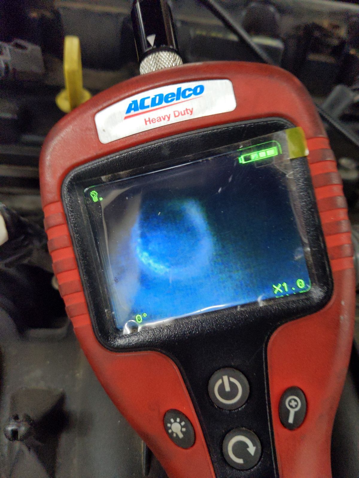

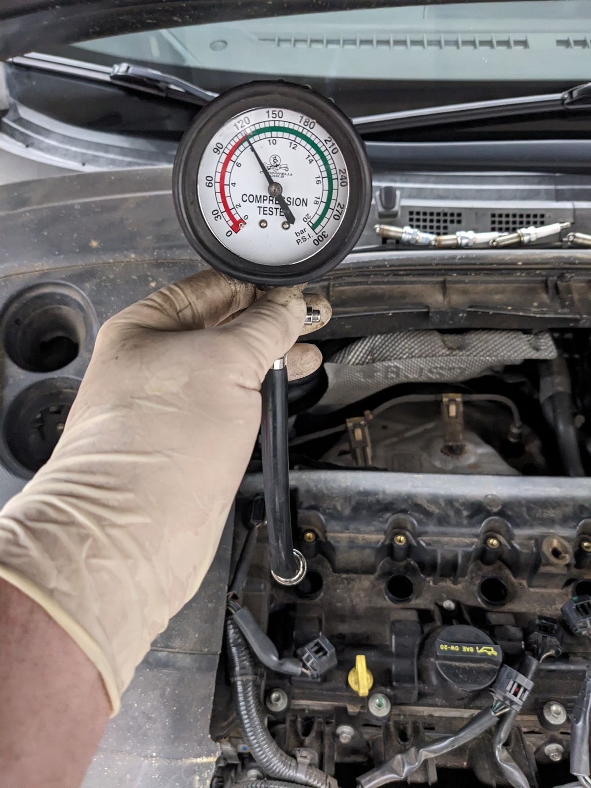

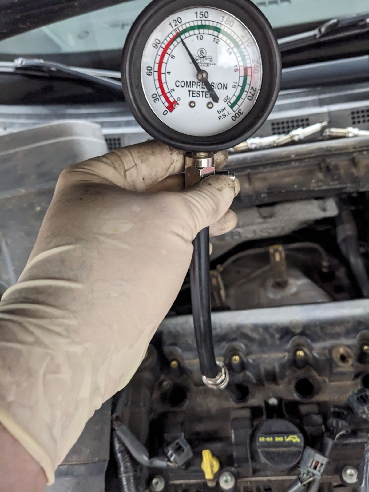

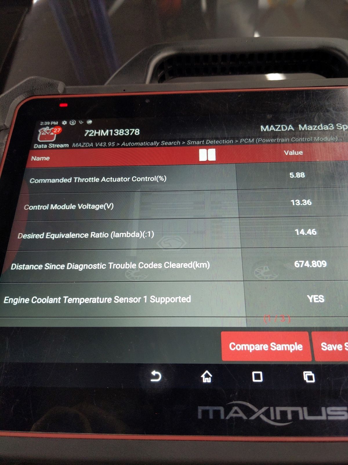

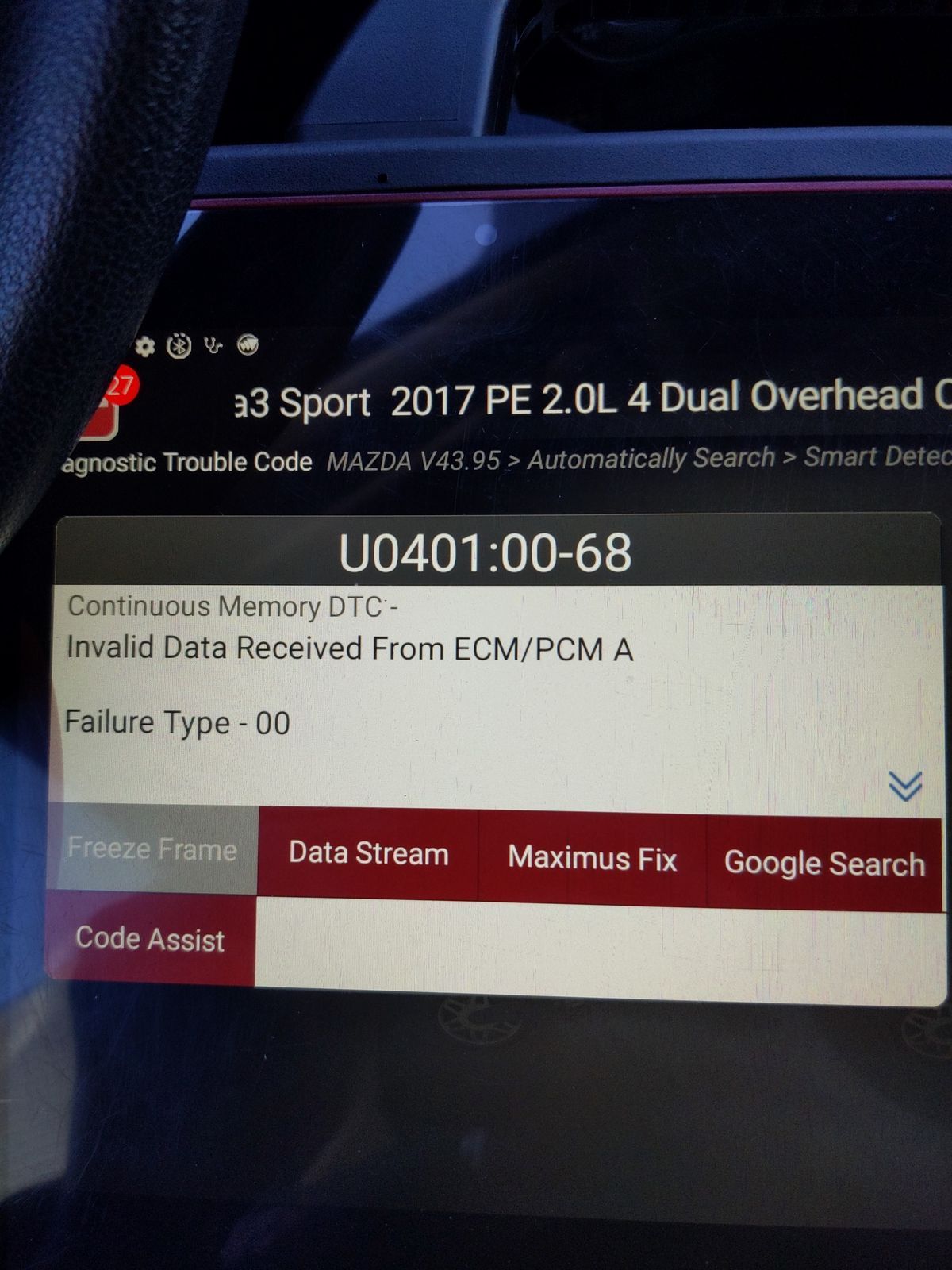

Quick update

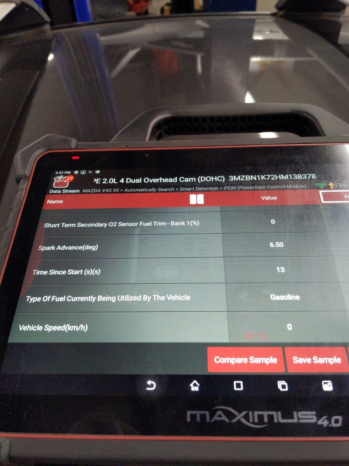

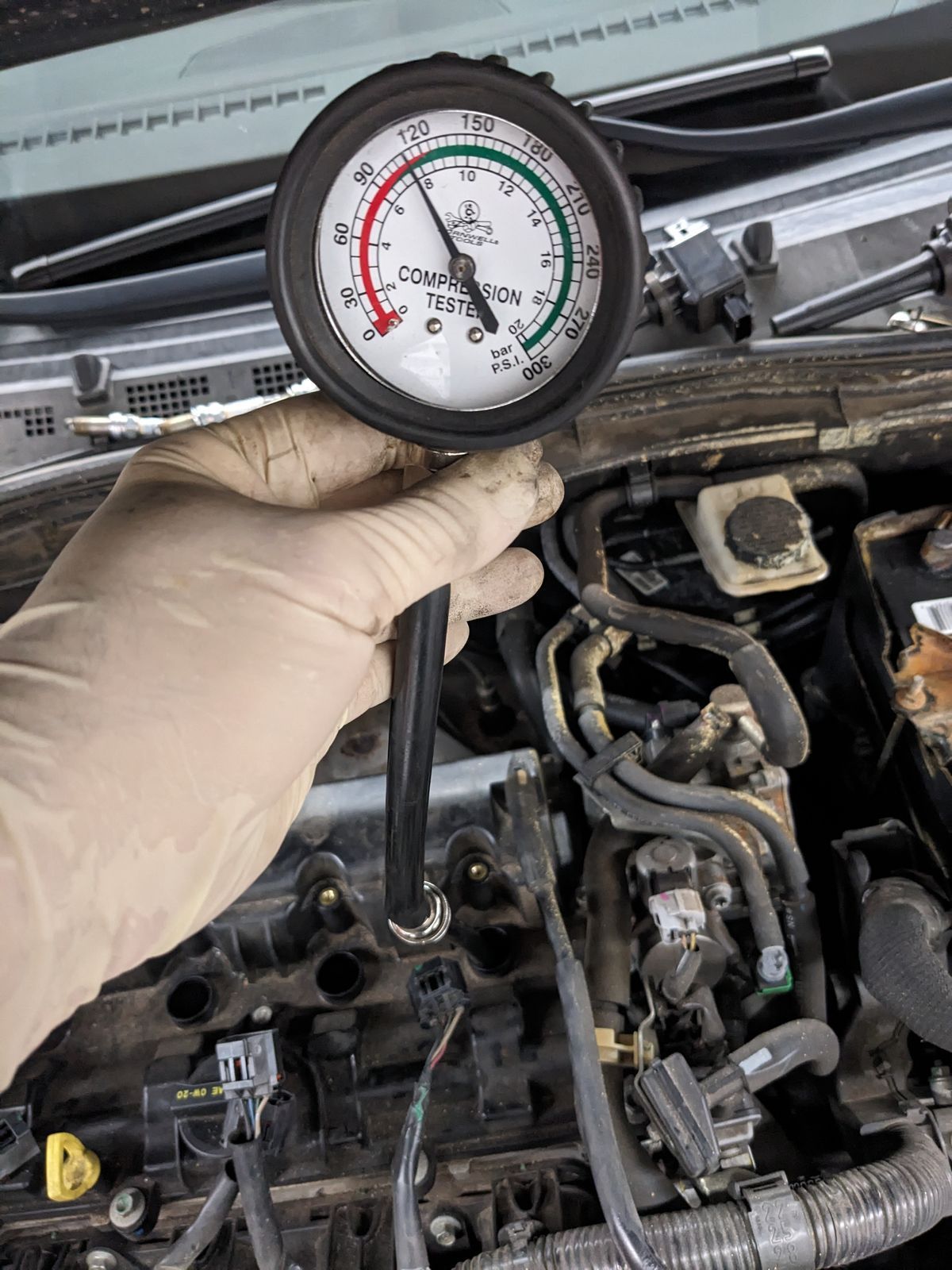

The check engine light came back on, and after a few days of driving, it was starting even worse and almost stalled out on me today (it felt clunky and stuttered on the road)
When that happened, I pulled over, turned it off, and restarted the car. That worked well enough for me to make it to a shop.

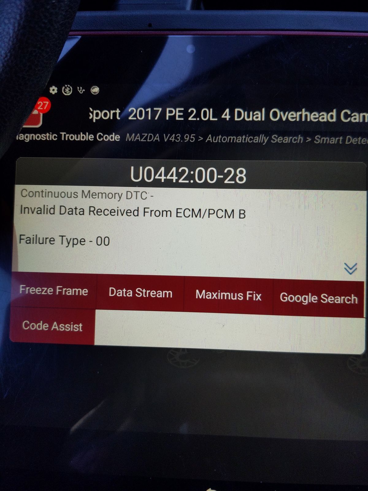

The mechanic ran a diagnostic and this is what they came back with:

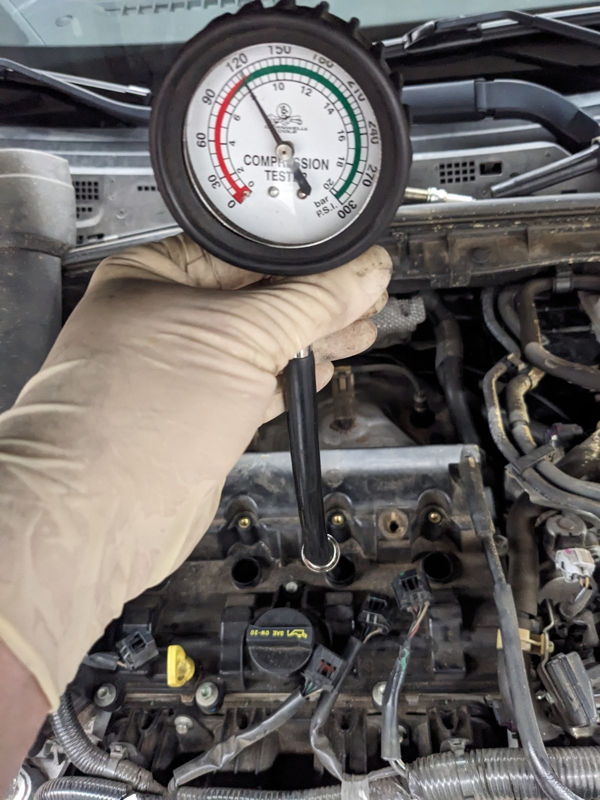

"Checked inside cylinders, and found the top of cylinder three to have a much larger portion having been "washed" by fuel. In the second to last photo under "Malfunction Indicator Lights" section, a minimal ring pattern can be seen to have been cleaned off top of piston, which is the same wash pattern from all three cylinders that are firing properly. In the last photo, there is a much larger portion of the top of the piston that has been washed. This indicates the fuel injector in cylinder three is leaking fuel into the cylinder. This explains the symptoms of rough cold starts - fuel builds up in cylinder three after engine is shut off, then upon starting, engine runs rough until excess fuel in cylinder three burns off. Intake has to come off to access fuel injectors, so an intake gasket is needed as well."
"Relating to misfire, found codes P0303 - Cylinder 3 misfire and P2308 - Ignition coil C secondary circuit. Verified there is an active misfire. Verified correct spark plugs and one ignition coil were installed. Verified swapping plug and/or coil from one cylinder to another did not move misfire, indicating plug/coil are not the issue. When disconnecting the electrical connector from #3 coil while engine is running, verified a heavy misfire presents, indicating the coil is firing. Tested and verified coil has power and ground. Verified that all four cylinders have correct compression."
"Replace cracked serpentine belt. Advise to replace stretch fit water pump belt as well. It is not cracked but appears to be original. Serpentine belt has to be removed to access water pump belt."

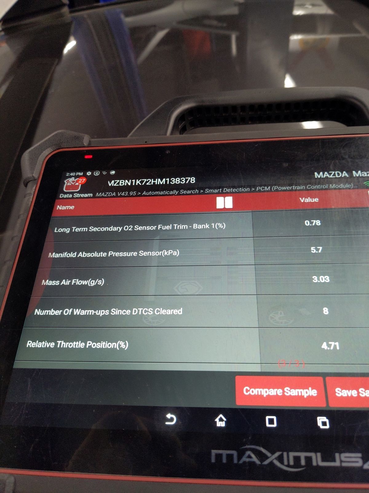

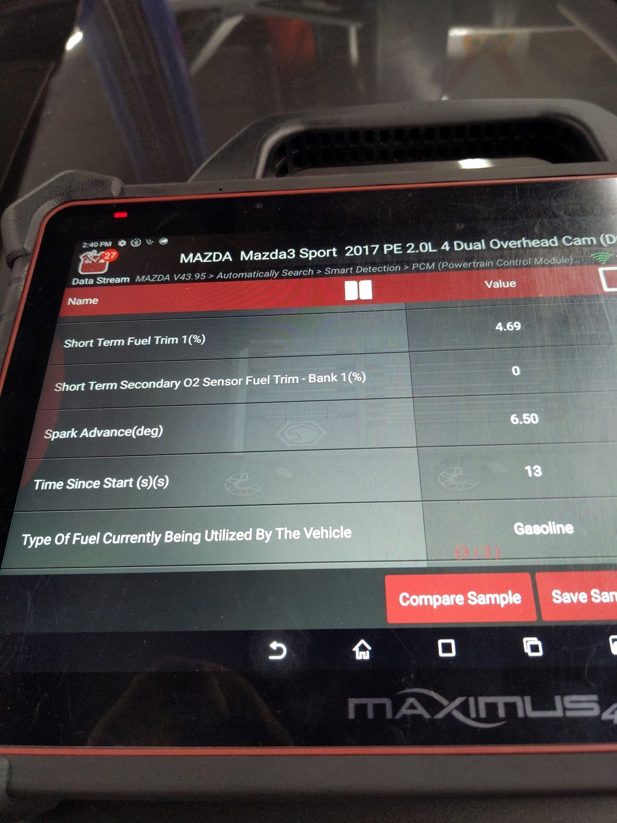

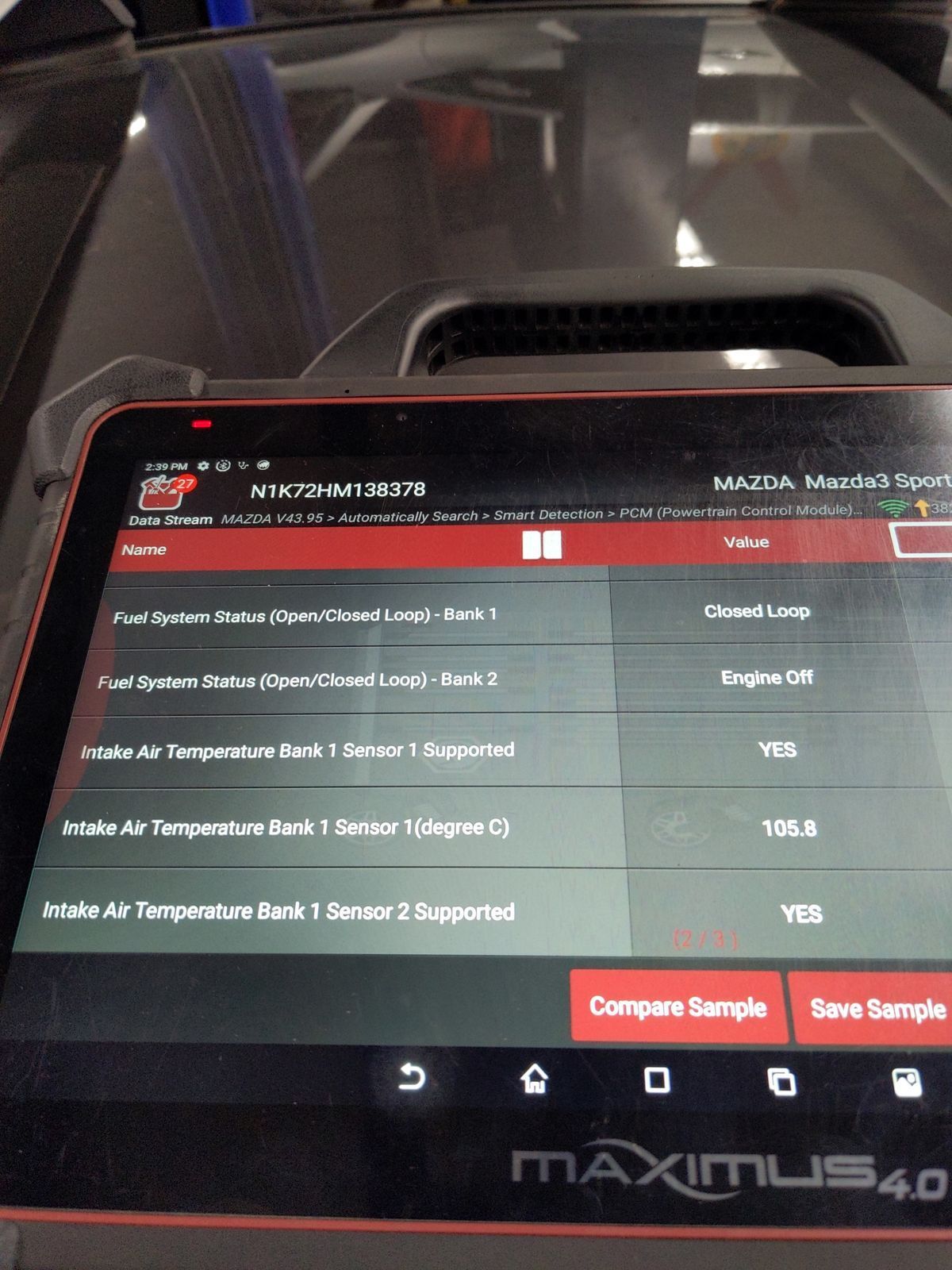

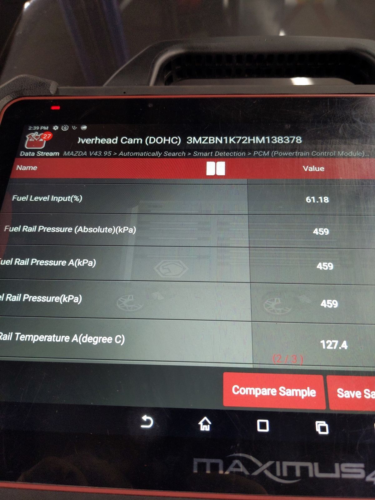

A lot of photos but this is what they sent me (minus the two that show the error codes mentioned above because I am limited to 20 photos)
Old Jan 10, 2025 | 09:43 AM
Posts: 10,574
Likes: 227
First I want to say GREAT info in your last response. I wish more would post like that.
I looked at the values and most all are within range and those that are slightly close to border line are what I would say normal for the miles on the engine.
I am not sure I agree with a couple of how the mechanic tested parts but that also seems a normal thing in some shops.
I am not sure what exactly the estimate is for. It is a little vague. Can you send me a pm with the detailed estimate? If you do, make sure it includes their hourly shop rate.
I am looking into that BG fuel service...not sure how they claim that works well on a DI engine? Thier theory is nice but the ECU wont like it? JOKE= an Italian Tune-up may work better?
I also like how they word installing a new water pump as a "chore"... Quote= "stretch fit water pump belt"

Okay, 10 days later and I have an update
The second shop is finished with their diagnostic and they are saying I need to replace the high-pressure fuel pump.
They are not like the first shop in that they did not provide a written explanation or photos so it's a bit harder for me to relay what they said over the phone.
It does sound like they tried a variety of things and ran a good amount of tests.
In total it was $275 for the diagnostic ($110 * 2.5hrs)
& they are quoting me $1,250 to replace the fuel pump.
I asked about the fuel injectors (because that's what the first shop said) and they didn't think that was the issue.
