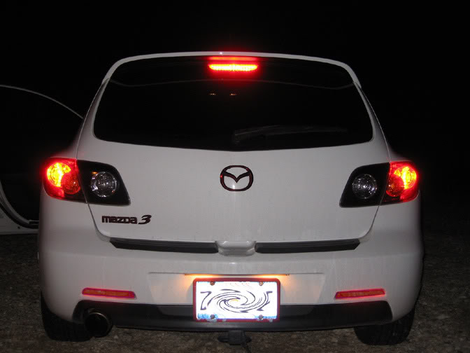

I bought the tails several years ago now... one of my first mods.I was hoping they would be brighter (15 LEDs) than the tungsten bulbs. They're not really, and they don't really look any different either, but do have a much faster reaction time which is the big plus.
LED bulbs have come a long way since then and brighter ones (20-24 high powered LEDs/bulb) are now available. I will change them out one day.
I've never liked that the tails are not easily seen by others in these cars.They are not the best design to be seen.I've had truckers stop to tell me my lower brake lights were out when they were working just fine because they can't see them from up there, especially during daylight hours. The third helps out a lot though. 60 LEDs pretty much fill the lens.

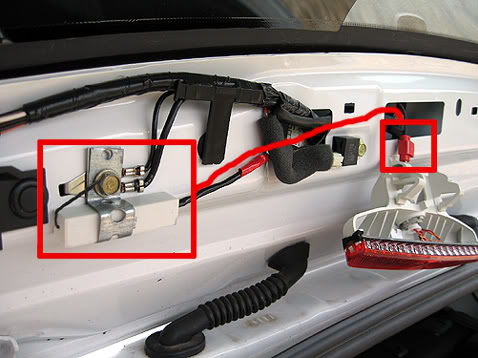

The Xenon store is where I got my third, high mounted brake light from and it's worked flawlessly for me.I did install a resister inline with it to avoid bleed-over from the turn signals. It's hard to beat for <$40. I love it!!
