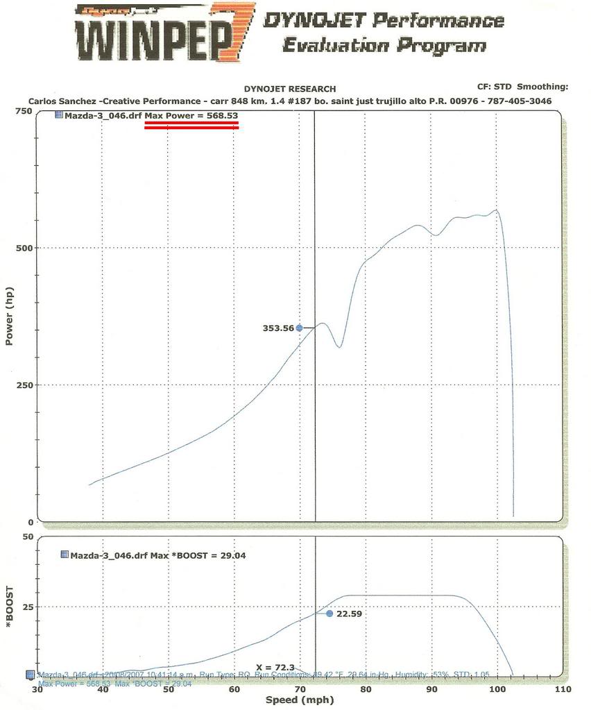

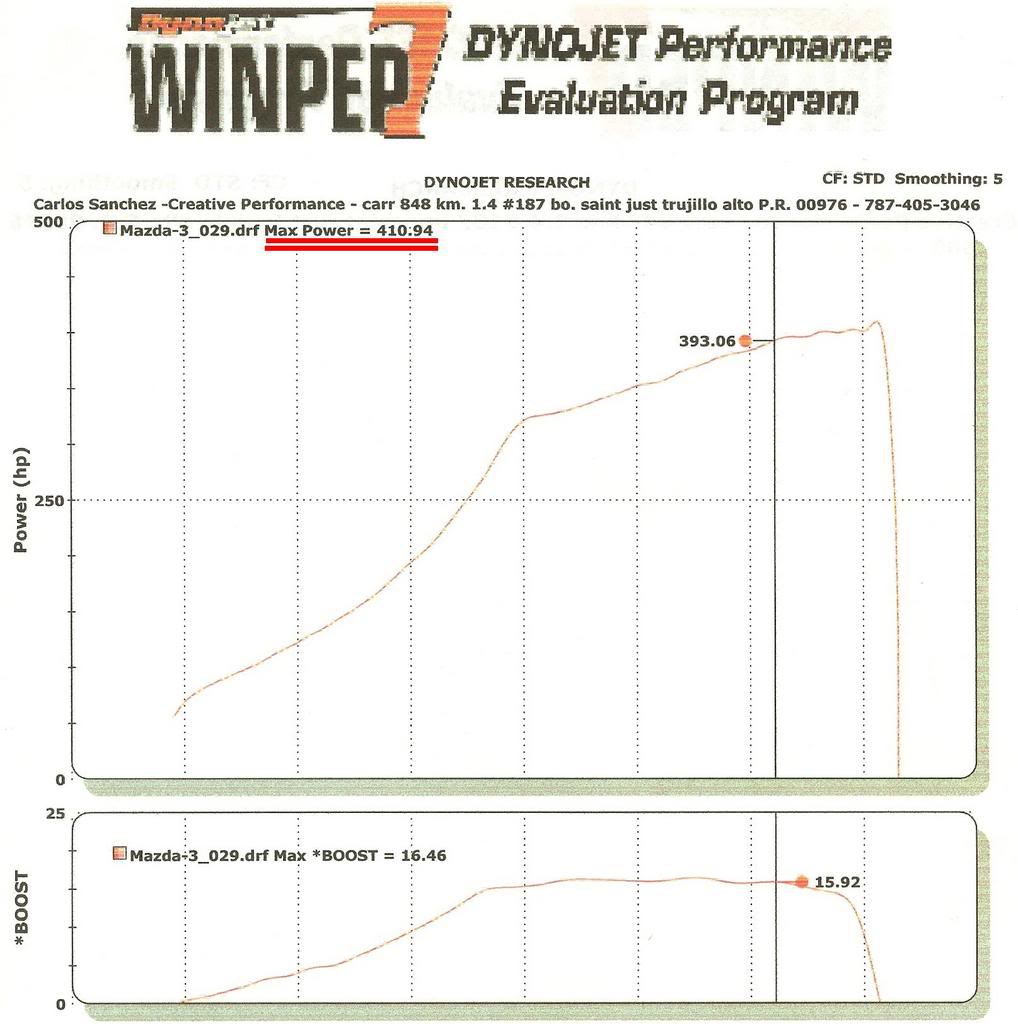

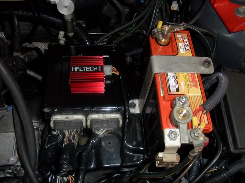

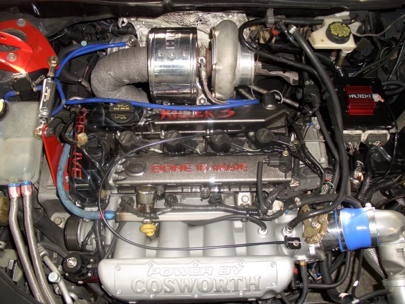

Well... After blood, sweat, many tears and a **** load of $$$ here's the final outcome. Right now the car is running strong!!! As of now I am running the Haltech E8 with the Haltech ruluctor adapter, the microtech x4 and ofcourse the beautiful Cosworth manni. We switched the ETB to a 70mm cable TB in order to manage the E8 full stand alone. Questions and comments welcomed.
Also, it has the old 3"intake but we will be installing a 4"with only one 45angle but we haven't gotten the piece yet so I had to stick the old intake back in there for now.
410whp @16psi on 93oct & 569whp @ 29psi on C16!!!
