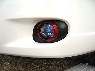

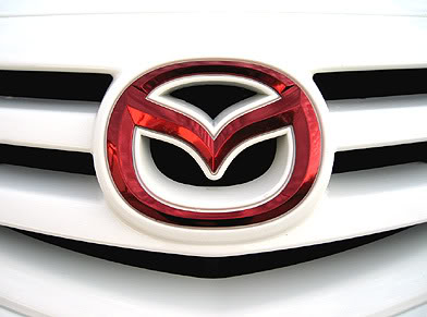

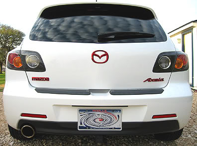

You mean like this?

Or this?

Or this?
They are painted using a transparent red. Additional coats make them look more maroon, the color that I was going for.
It is not necessary to strip the chrome plating using hydrochloric acid, but if you want them to last more than a month before having to redo them, you will need an adhesion promoting primer and a UV protecting clear polyurethane as a top coat. It's clear and turns the chrome dull... though not permanently. Lacquer thinner will take everything back off again and back to chrome.
BUT, be sure you want to commit, because once you do you'll be repainting them about twice a year.

That is exactl what I am talking about. Didn't realize that it was a do it yourself-er. Either way the result looks really good.

BTW: The best of those pics, color wise, is the fog light surround, though in sunlight they will fade and eventually turn orangish if not redone. The others got kinda' washed out and red-pinkish looking from the digital camera.
Also, the front will tend to chip and may need redoing before the rest.
As I'd said, it's a commitment. You sure you wanna go there?
