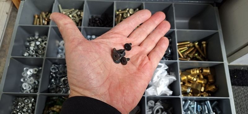

Someone installed that and it is NOT a Mazda fastener? Those are a black oxide universal screw and they will rust if not painted ..
I use those in the same area's at time but paint mine before installing them. They are great for plastic body parts and do not require drilling to use them.
so NOT a MAZDA part!

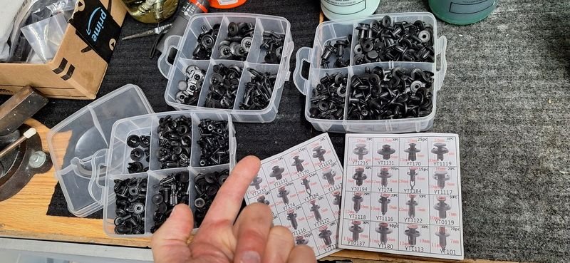

In your own picture next to that screw that was not installed by Mazda is the CORRECT plastic fastener factory installed!
Look we can debate but if Mazda did use that type it would have been coated to prevent rust and it would have had a securing plate on the part it was being used for.
Now don't make me go take more pictures of my fastener supply to show you. LOL
Look someone thought that adding those in that location was to solve some sort of issue plain and simple. This is not rocket science but it is also not an oversight with MAZDA either.
