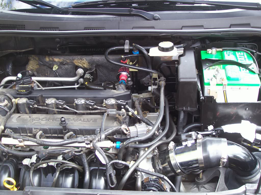

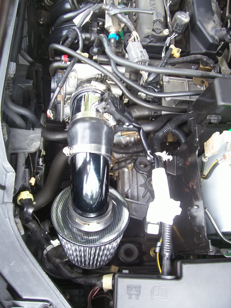

i installed a SRIinstead of CAI therefore taking away the whole bumper removal hassle, but i do have pics- Name:  100_1045_00.jpg
both before my heat shield i installed to keep some extra heat away!!

nicely done. easy install...mine was a bich. but why do you have a red fliter over there what is that for...bypass?

yes, the intake was basically custom built and i didnt feel like welding a piece in order to connect that tube,so i replaced it with the filter which works just as well.

It's just a breather. In stock configuration (as you know) the tube is connected to the intake and uses the vacuum to suck outgasses that form in the engine block.now, no vacuum and it's allleft up to the pressure in theengine block to expel the gasses. I would think that if anything (however small)it would be a decrease in performance, though I'mquite sure not detectable.
Stick w/theintake hose if you can.
