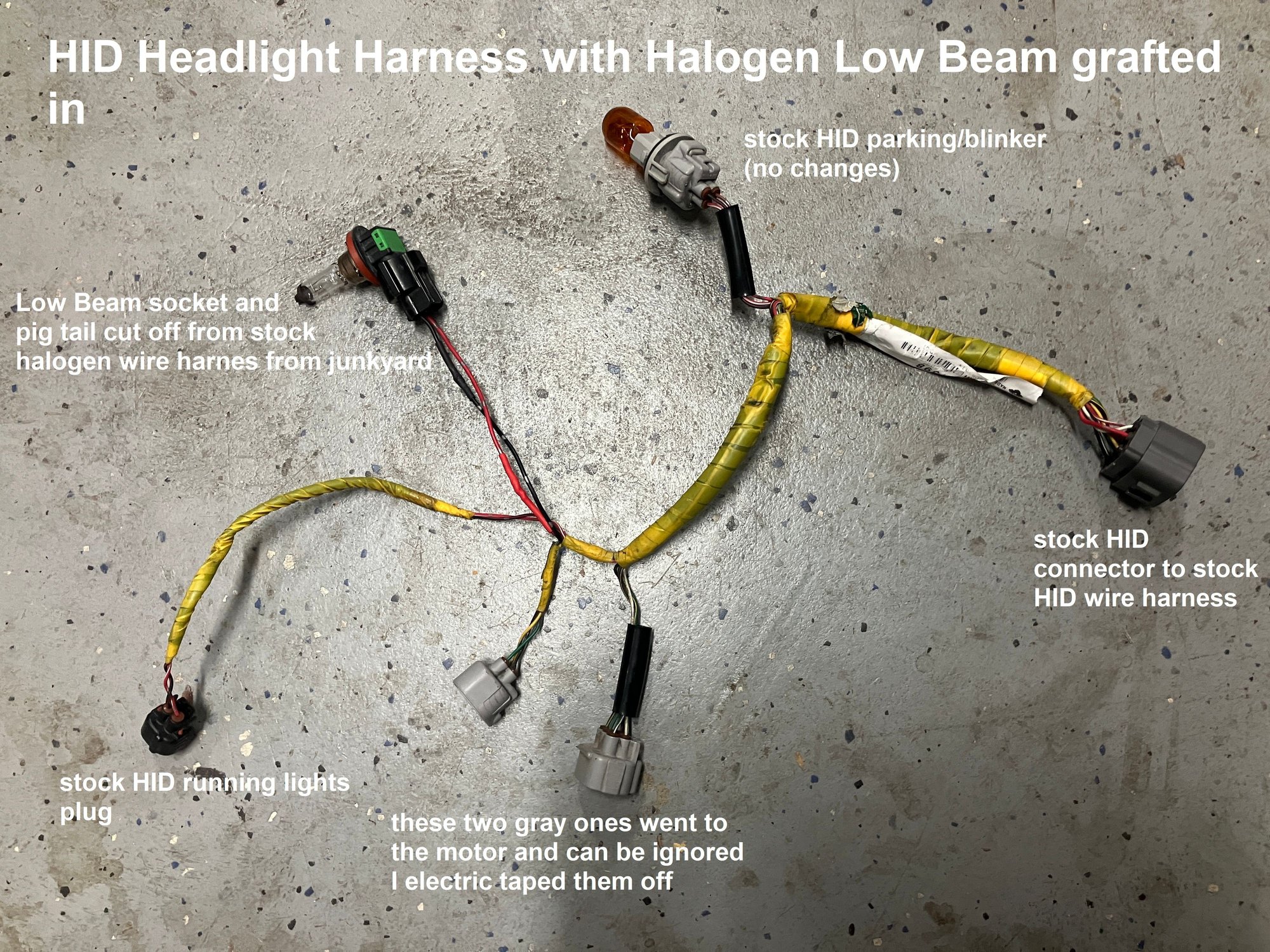

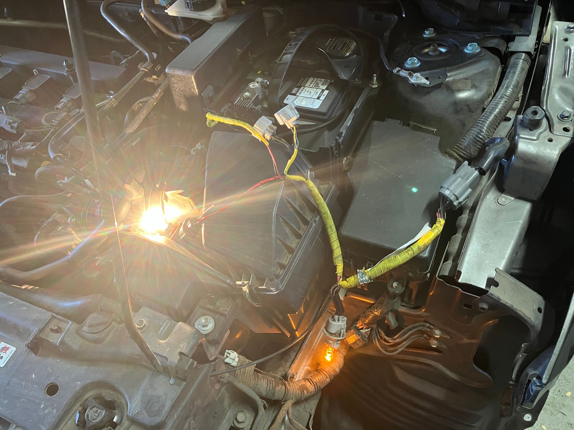

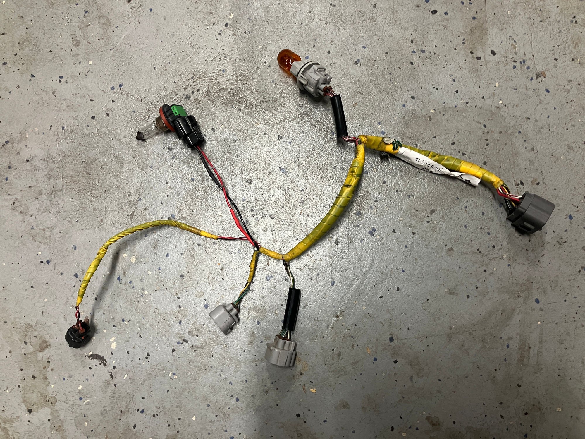

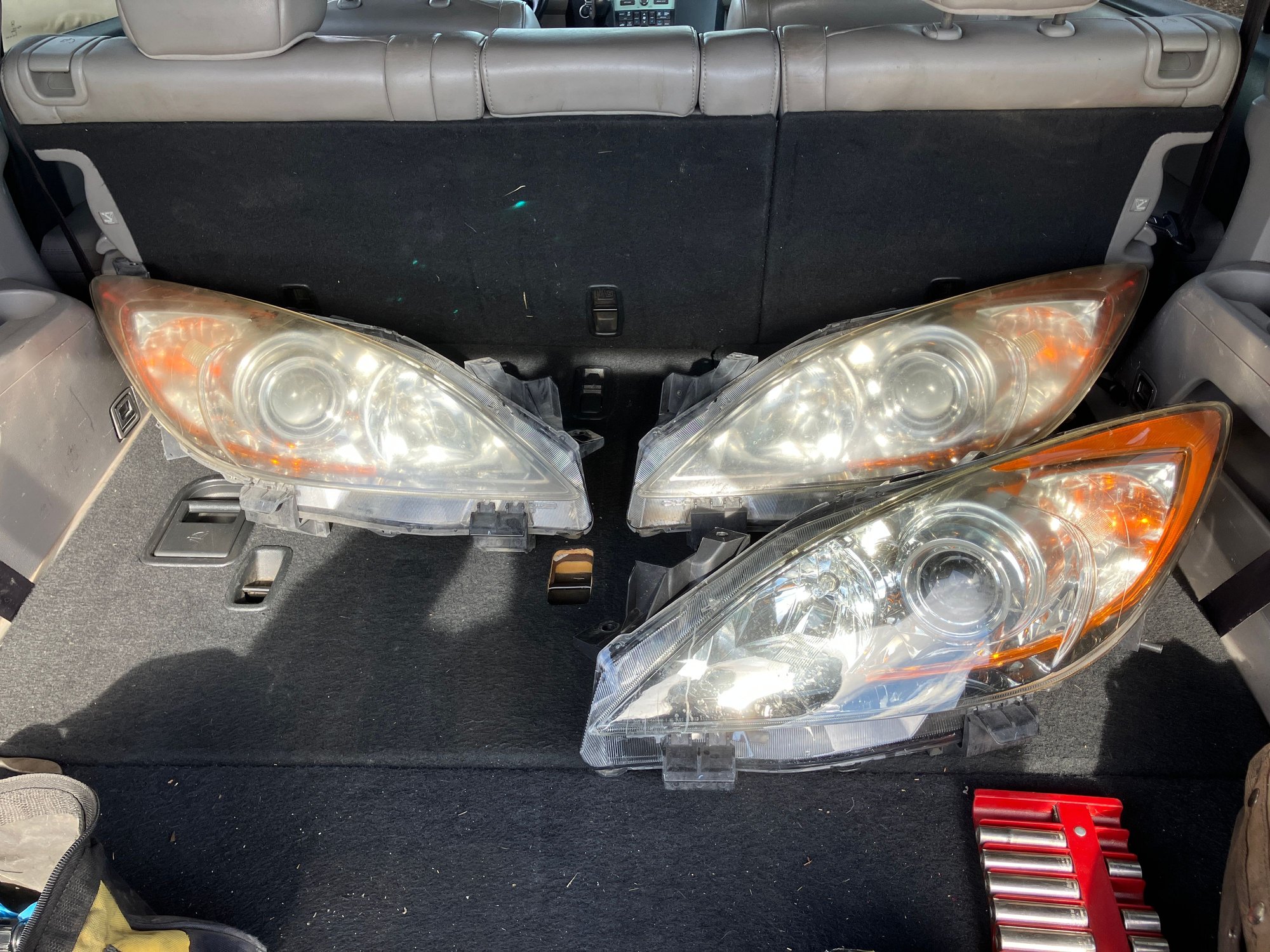

I know how you all feel about resurecting old threads, but I feel like we did not get an answer here if it worked and how it was done and I don't like starting redundant threads. Our daughters 2010 Mazda 3 HID auto leveling headlights were both full of water and the ballasts were flooded and obviously broke, the dealer wants $1,400 per headlight and the Interwebs want $1,000 each, so I went out and bought two used basic model Halogens at the junkyard with no running lights, as simple as it gets, and I have succesfully adopted the HID wiring harness to them
Turns Signal / Parking Light is exactly the same and just snaps right in - no changes needed
Low Bean - I cut off the HID plug that ran to the ballast and soldered the Halogen low beam plug to it, works great
High Beam - I don't know how to get these working hence the post
Running Lights - her car per the VIN does not have running lights (although the current HID assemblies have running lights and running lights wiring harness in them but they don't work, someone must have swapped the original ones out at some point and installed these in) so I am not worrying about those, but for extra credit if you could tell me if there is some way to make the running lights come one, enable them in the computer or what ever that would be great

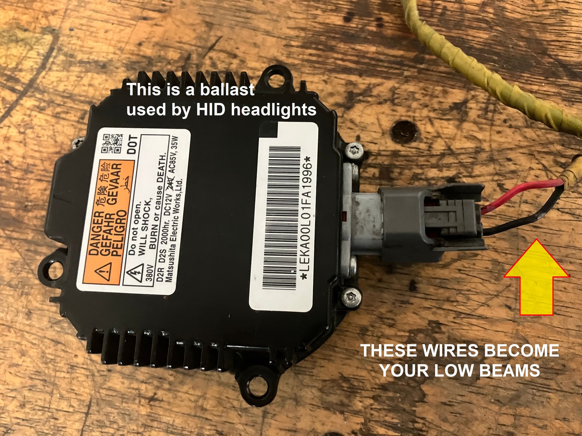

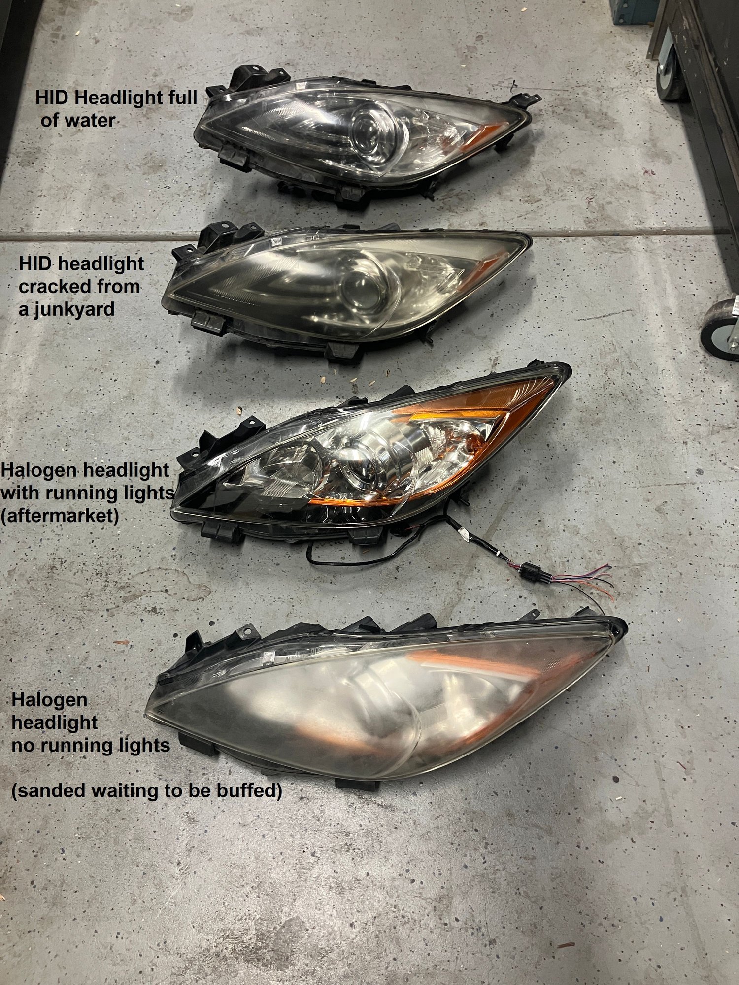

Can you convert HID headlights to "regular" Halogen? YES
here's how I did it
1. buy the regular halogen headlights with their wire harness on the back and bulbs at a junkyard (make sure they have most of the three clips/brackets if not its not the end of the world) I paid anywhere between $30 and $40 bucks for mine (these may come as super basic aka no running lights or what I call basic with running lights) FYI the lights in the chin of your car are Fog Lights not running lights, the running lights are an extra light bulb inside the actual headlight housing
2. take the black and red wires that go to the HID ballast and cut the plug off then solder on a pig tail from a regular Halogen wire harness you can snip one off at a junkyard, 97% of wrecked Mazda 3s at the junkyard have regular lights not the HIDs lol
What about High Beams, sorry guys I don't know how to make the high beams work, that's why I posted that guys video so you can see how the HIDs operate. Feel free to learn me how to make the high beams work in this swap / conversion.

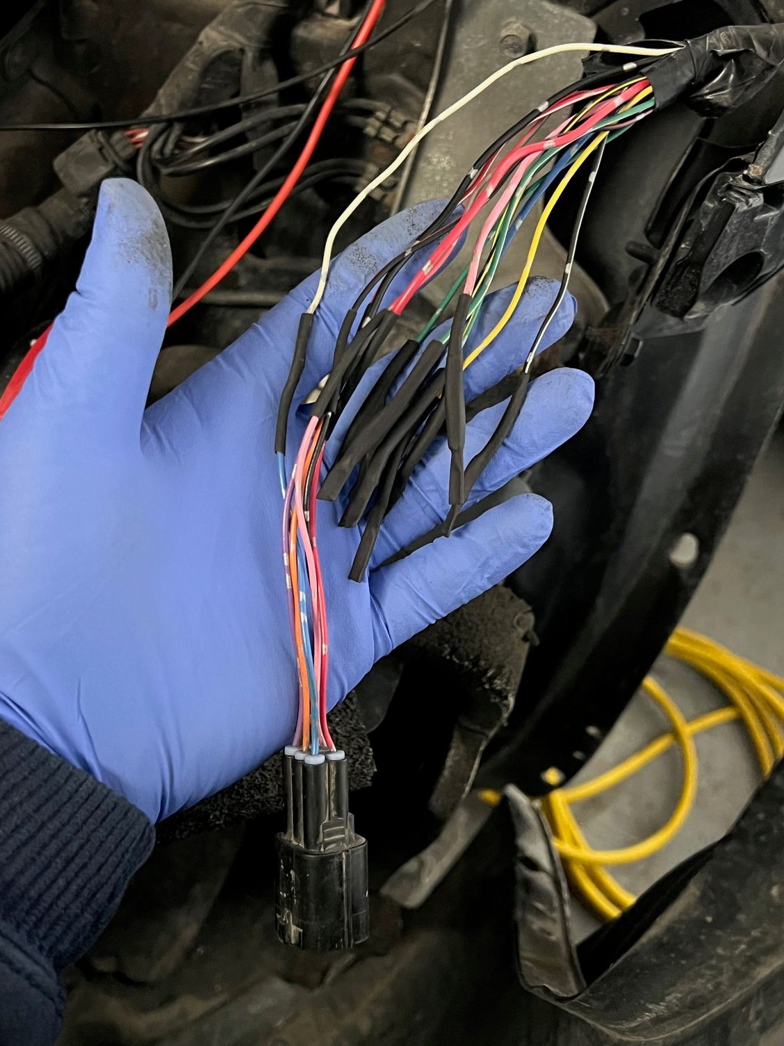

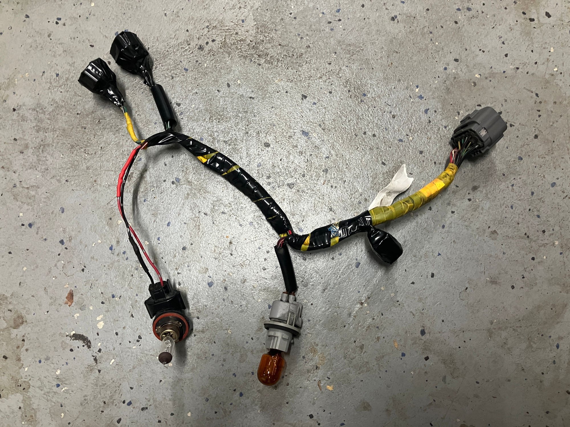

For context, I have the Canadian version of 2010 Mazda 3 GT with the HIDs, DRLs, and AFS. I also have access to AllData, so I could check the wiring diagrams. The connectors for each assembly, stock, has 14 wires. However, the colors on the car didn't match the colors from the diagram, but the location of each pin matched.
I attached a bunch of PDFs for reference. I also put a reference for myself to know which car wire should be solder to which assembly wire. Important note: my own connector drawing is from when you look inside the connector; while the connector diagram from AllData is when you look from behind the connector.
I tested all pins using my multimeter and switch the lights on and off. Some pins (for AFS) were hot at all times.
Basically, I got used Halogen assemblies from a junkyard, and took the assembly wirings along with it, and also cut the car side of the connectors, so that I have matching connectors and pins (the pins that go into the HID connector are not the same model of pins that go into the halogen connector).
When you solder the ballast wires directly to the halogen low beam connector, you just directly connected it without going through the harness. However, that blocks the way of connecting the high beams.
But basically, as you can see from all the diagrams attached, you need to take the white wire from the car's connector and link it to the wire that will become the wire in the assembly connector.
Since my car came with DRLs, the wiring is very different than if Halogens came with DRLs. So I thought safer to not connect any DRLs (it is mandatory for manufacturers in Canada to make cars with DRLs, but it is not mandatory for drivers to have them (I think..?)). So no more DRLs for me, but I don't mind. Their purpose is for people to see you, not for you to see.
I cut and solder all used wires (1 low, 1 high, 1 parking, 1 flasher, 2 grounds), and protected all unsed (1 ground, 1 DRL, and 6 AFS) using shrinking tubes (I don't think tape alone is safe); as you can see in the picture below.
The whole thing took about 4-5hrs, mostly because of the unpinning and soldering of the wires together, since the pins aren't compatible.
Hope this helps! It took me a lot of time understanding the diagrams, so feel free to ask questions if needed.
