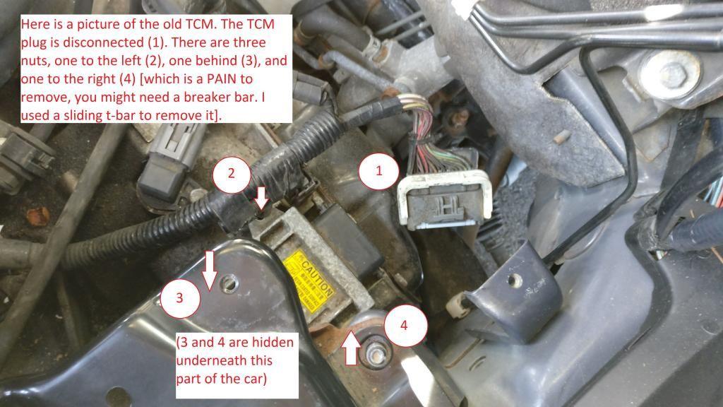

Default Change the location of the Gearbox computer mazda 3 2 AT
The computer is on the gearbox Does Gearbox heat up the computer?Gearboxes usually break down in kilometers 100000 or the heat can break down.Do you think I would replace a computer with a gearbox that didn't heat up?
