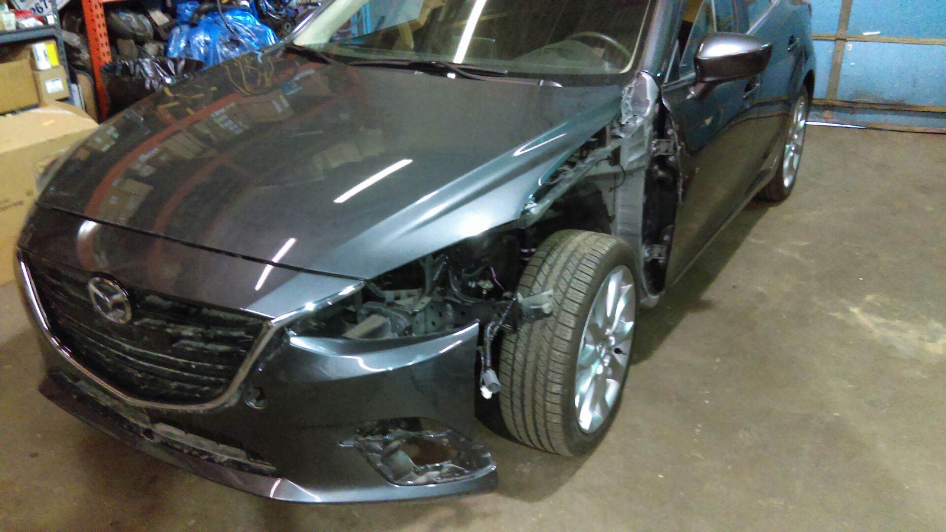

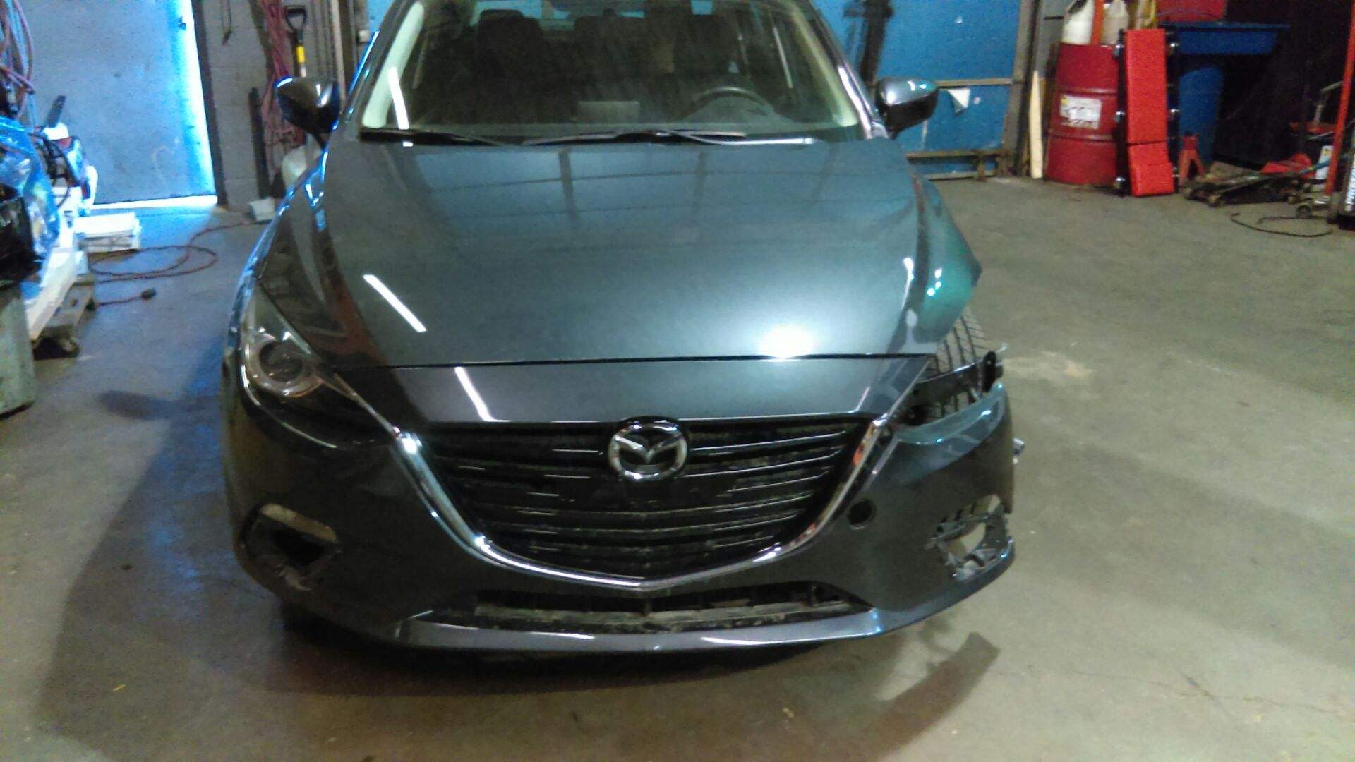

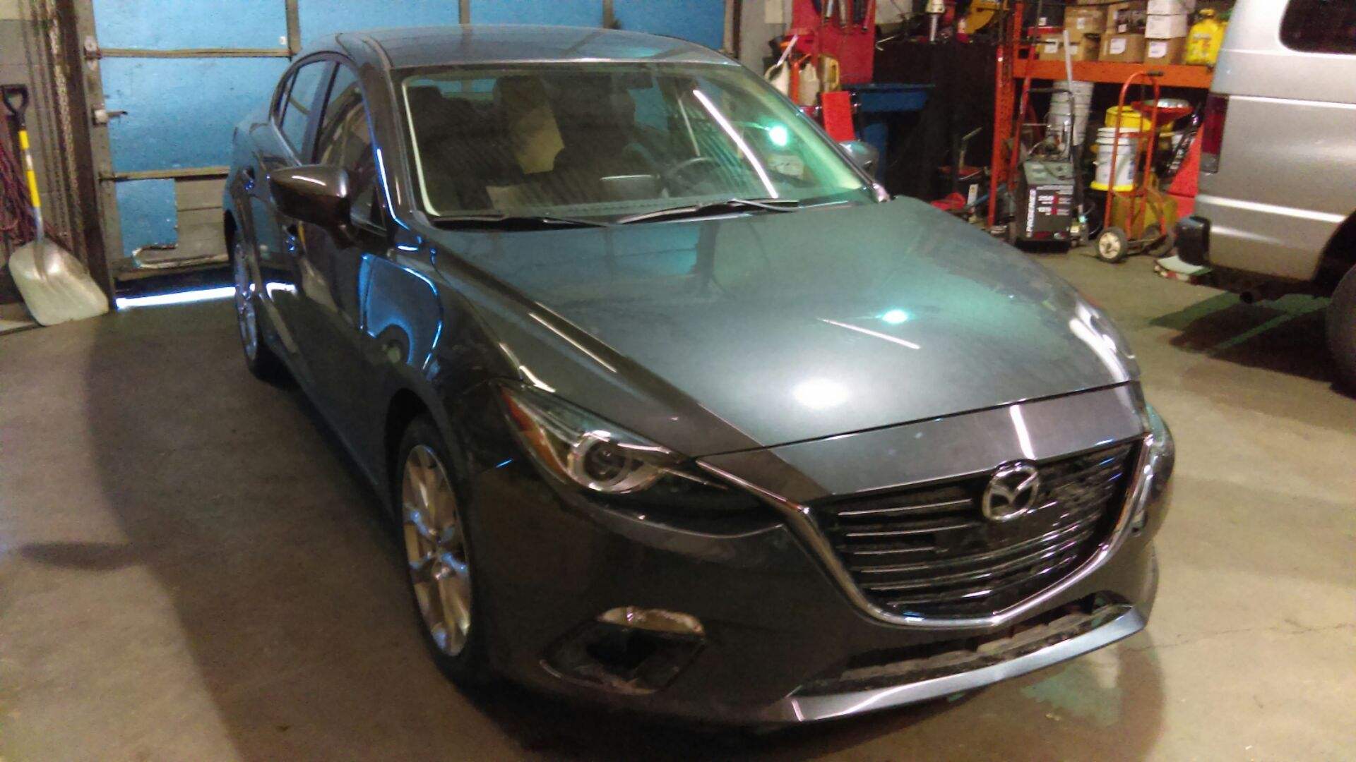

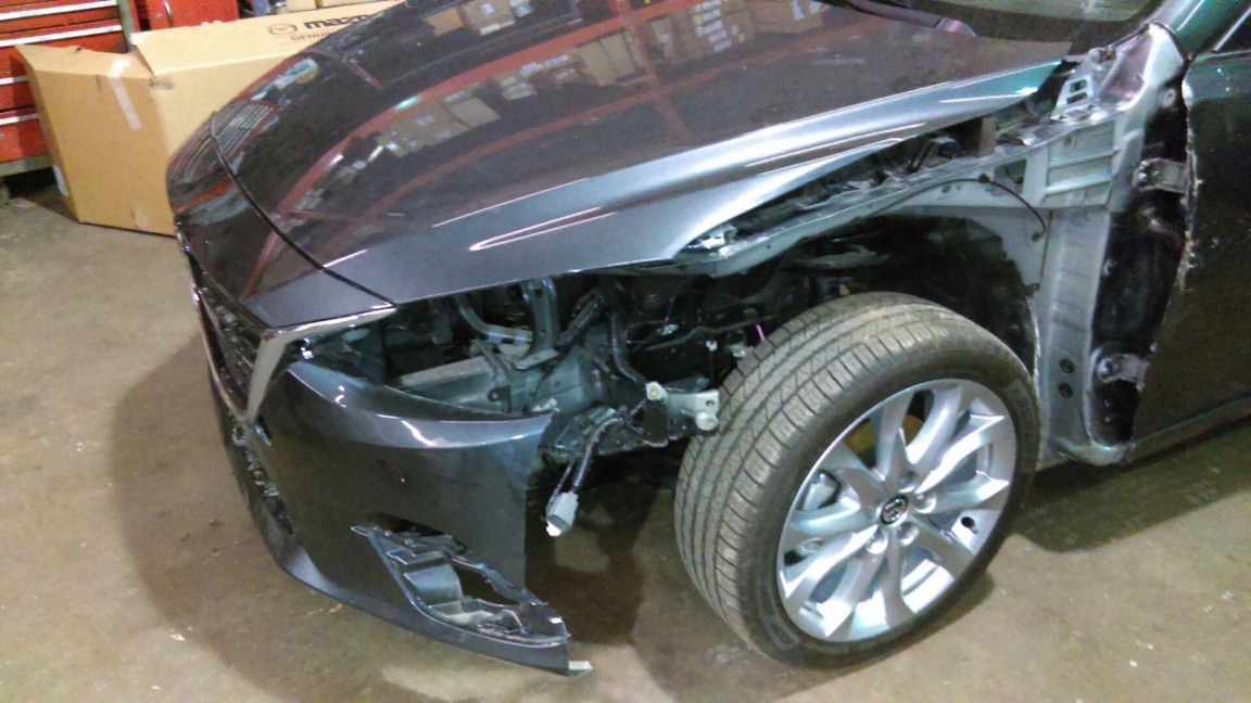

I don't believe that the powertrain was harmed during the accident by looking at the photos, but I could be wrong. The owner told me the front was took a light hit and that there wasn't any damage to the powertrain.

I'm not seeing anything alarming; all is easily repairable. This car sounds like a great deal.

Understandable, and from what I see in the pic's, damage looks cosmetic. My only concern is in the 3rd pic, is that a crease above the windshield between the driver and the rear view mirror or just a reflection? If it was a crease, that indicates structural damage and would explain why they totaled it. Wind noise, excessive tire wear, poor handling, smells funny when it rains, you get the idea.
The Skyactive powertrain is pretty solid. There is always the unexpected and since neither you or I were in the car when it got hit, there is no way of telling what it went thru. If the car drives out ok, no rattles, wind noise water leaks etc., you might be fine.
