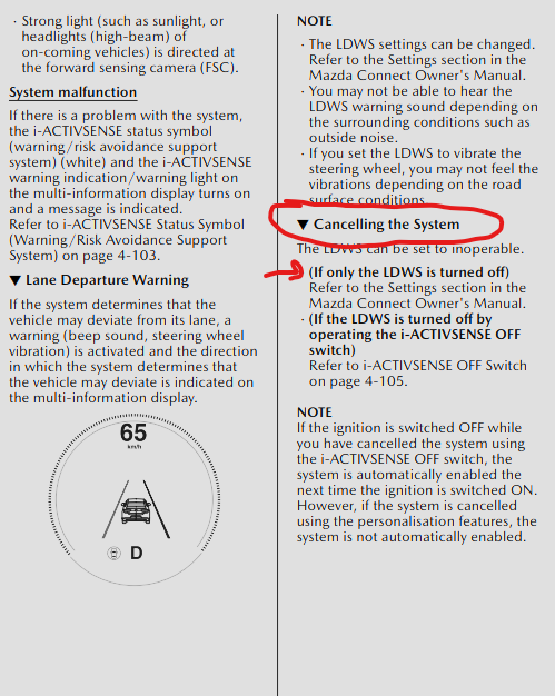

I've got a 2022 UK spec Mazda 3 and have managed to turn off the system from one of the menus. It's in the user manual somewhere.
Not sure if it's the same for U.S. spec versions but here's a reference to it in my manual

First time I found it in the settings menus and turned it off I was a bit dissapointed that it came back on the next time I started the car.
Found out you have to have the ignition on whilst changing the setting in order for it to become a persistent change. Guess I should have read the manual a bit more carefully as it does say that, as shown above.
