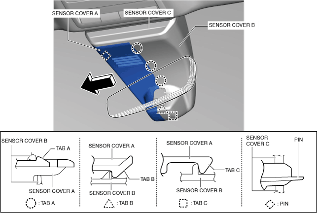

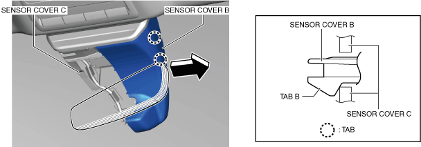

Hi,
First post. Please forgive me if this has been answered before, I did several searches and found one video that partially covered what I am trying to do....
I bought a Chamberlain replacement mirror with built in garage remotes. Trying to take the old mirror housing off so I can get to the mount. There is a front piece that I can loosen but can't get out due to clearance with the headliner. And the shroud itself seems to be two pieces. Anyone know an easy way to remove these 3 pieces to get to the mirror mount?
Thanks!

Default Sweet!
Woke up to this spot on response. Thanks a million.
