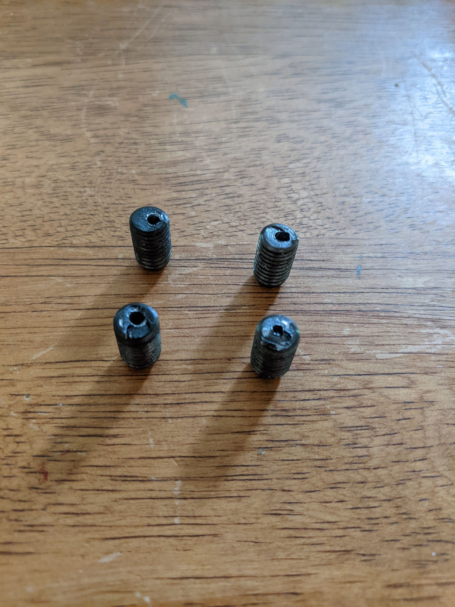

When this car came to me it had bad exhaust leaks from both exhaust manifolds, professionally diagnosed with only snapped studs.
Think I'll make these into a commemorative keychain
