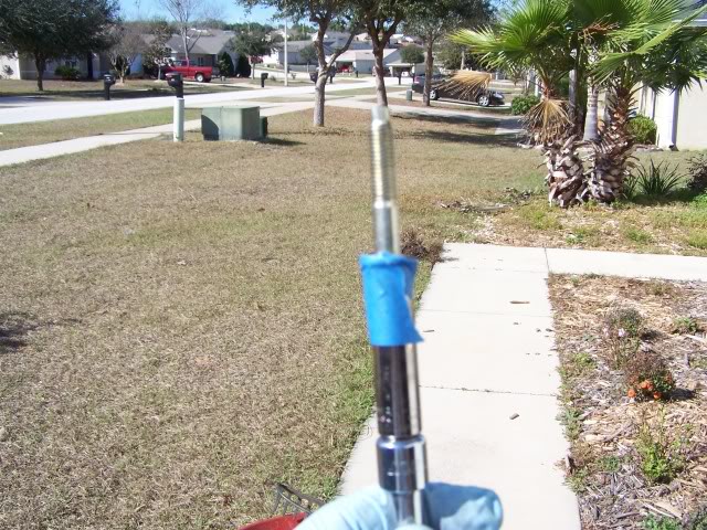

17. Installation is reverse of removal with a few things...May i suggest you use "the old sticky socket"
Attachment 5049
Unless you know how to swear in several languages. Also in this repair a little telescoping magnet will save your butt!
The tape is strong enough to hold the bolt but snaps off when you get it tight..down side is if you use too much tape, the tape stays on the bolt and not on the socket..its takes some experimentation but you get the idea.
