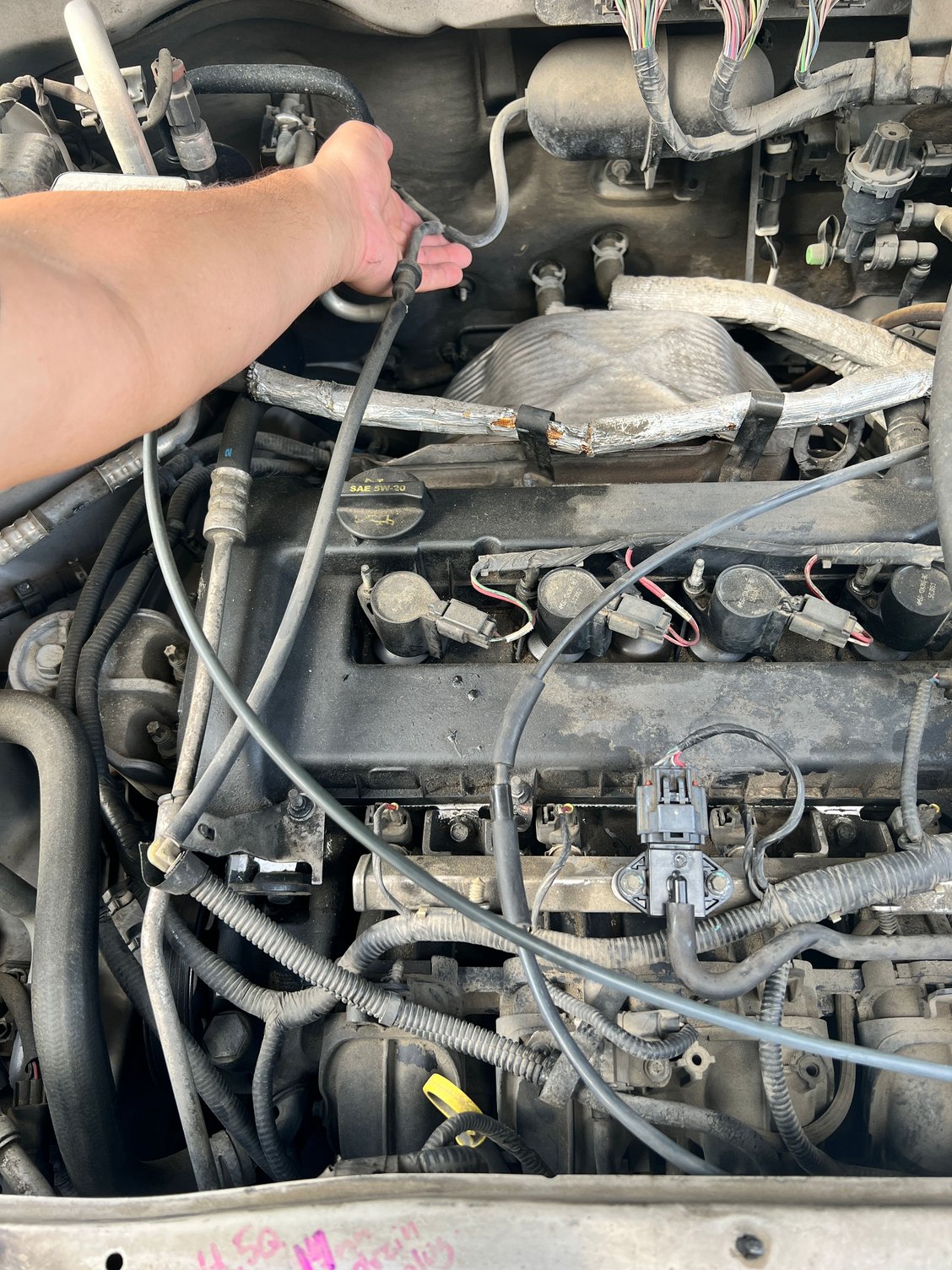

Do you know about where in engine bay?
Been having the same problem for about a year now. 2006 Tribute. Not pleasant in south Louisiana during the summer.
yes its on the top of the engine bay near the back if I remember correctly. Just woke up and having breakfast right now. I’ll go out there and take a picture and post it.

That’s the hose. Somewhere in that hose it was corroded. In the second closeup pic you can see that another section is now corroded too.
