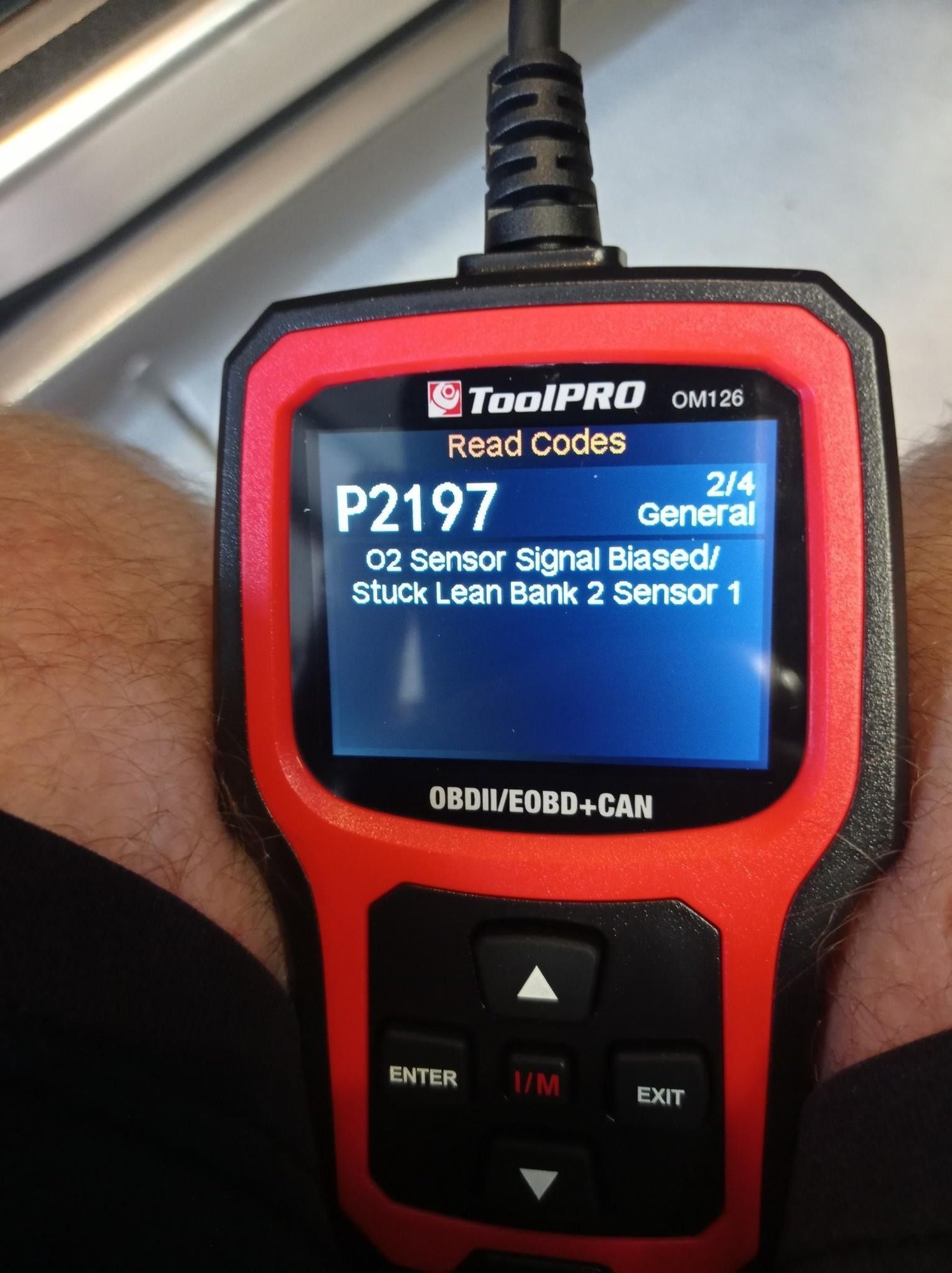

Hi all! My 2007 Mazda Tribute V6 broke down a week ago. I filled it with petrol, stopped on way home for 15mins to get food - then when I went to drive off, I got 50 metres and it stalled. When I tried to restart - it would start but died again as soon as I pushed on accelerator. Repeated attempts made no difference....it idled (roughly) but when accelerator was applied even slightly, the engine spluttered and stalled. (It was a very warm evening, but car hadn't overheated)
RAC check brought up 'running lean' codes. Car had to be transported home.
At home next day when engine was cold it idled rough for a few secs but died every time accelerator applied. While checking/working on engine and using 'Start Ya Bastard' it started to idle more smoothly but still cut out on acceleration.
Used OBD11 Tester which showed 02 Sensor Codes P2195 and P2197 (see attached images)

I eventually nutted out the problem after being led astray with my brand new fuel pressure gauge being faulty making me think I had a fuel pump problem. After eliminating the fuel pump, I studied the output from all the various sensors using my OBD2 tester and found that the MAF sensor readings didn't seem to change, but as I could not rev the engine above idle, without it stalling, it was hard to confirm. I did notice that the MAF output remained constant (the same reading as at idle) even when the engine was not running. I decided to confirm this by squirting some Start-Ya-Bastard into the intake and getting it to rev up for a brief moment but the MAF output still remained the same. I then thought to disconnect the MAF connector to see if this made any difference. The engine then burst into life confirming the sensor was faulty. I ordered a new one and fitted it and problem solved! Thanks for all the support.
