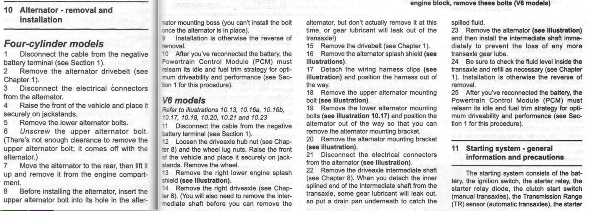

Lots of videos on YouTube, discussing removal of the alternator on Mazda Tributes, which make it seem like a tedious process. The placement on my manual transmission, 4 cylinder DX looks pretty straightforward, with easy access to the bolts from above. Is it as easy as this placement (vs. the automatics) would indicate?

I found my answer, and the answer, thankfully is yes.
