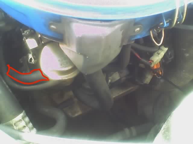

There's a hose you should check. It's a pretty big vaccume hose that could be cracked. It goes from the air intake valve (?) to a large port on the back of the intake manifold. It attatches just above the exhaust manifold, so it's exposed to a lot of heat, and will crack at the bottom elbow. I'll try to find a pic of the hose.
Old Oct 16, 2005 | 04:38 AM
bstrange99's Avatar
Joined: Oct 2005
Default RE: Can someone help?
It's the hose outlined in red. I would start with that, and replace it if it's cracked on the bottom side. You may have to remove it to see the crack.

Forgot to mention that one bstrange99. that is a very common one also. Good picture showing the problem hose.
