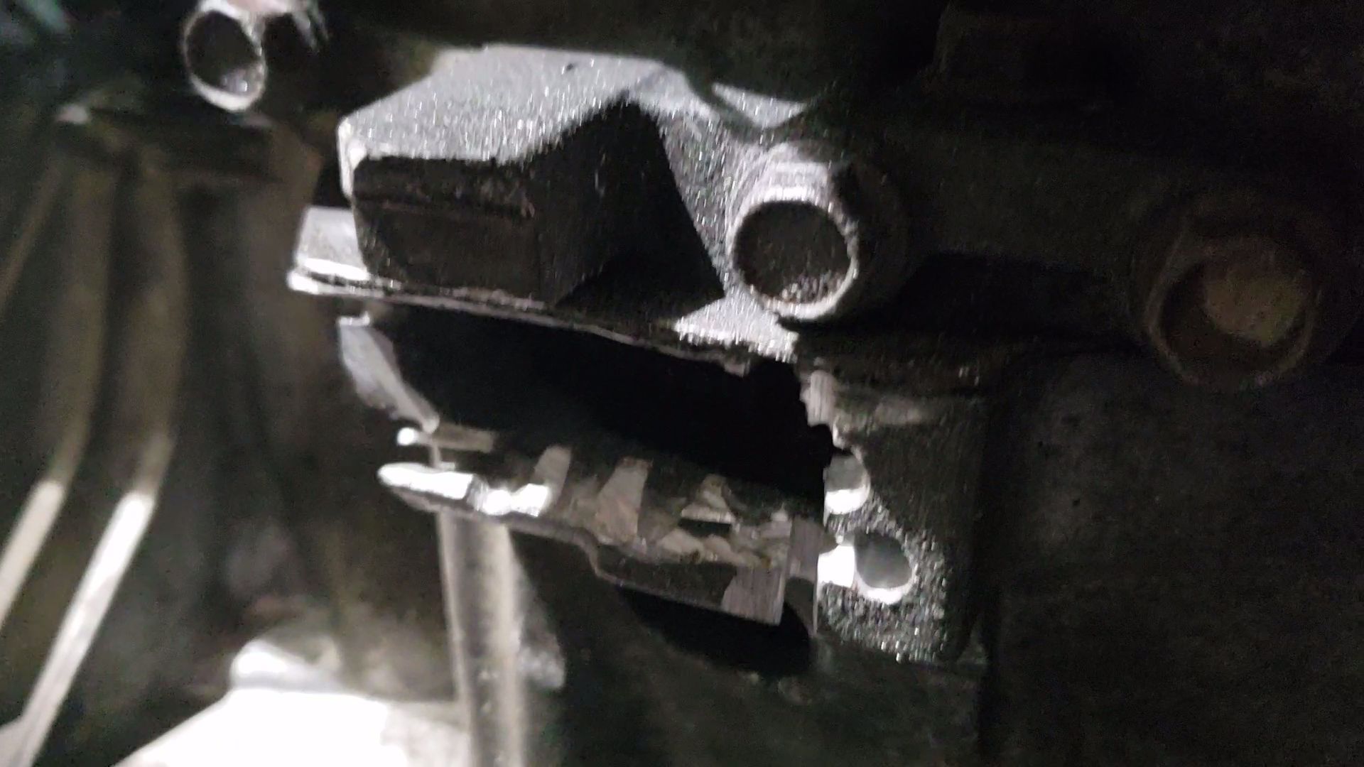

I purchased a used trans from a used parts place. I noticed it had a notch cut out in it. I later realized what it was for. Its an access to get a wrench on the torque converter nuts from down below. So i cut one in mine. It wasn't as nice of a hole but it worked. Who cares if your getting rid of the trans. I put a wrench on it while holding a ratchet on the crank pully bolt. With a pipe on the wrench i was able to break it free. This saved me because those nuts were not coming off. Hope this helps someone else since there is no documentation on the subject anywhere
