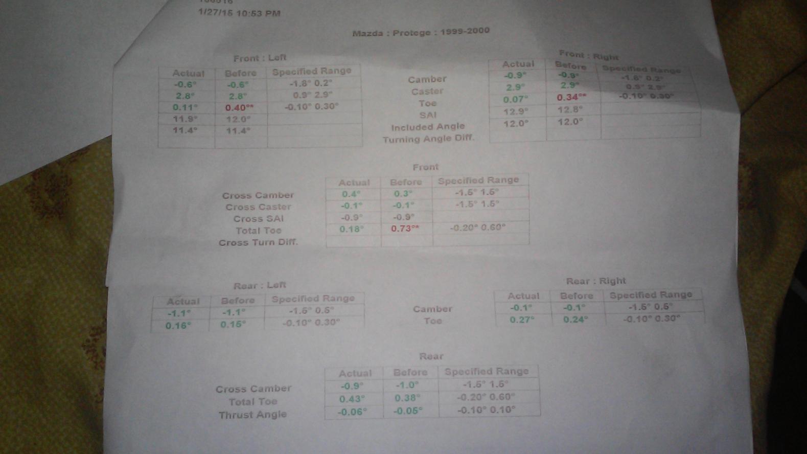

hixx here attached is the alignment sheet that i got:

it seems only the toe needed adjusting and the caster/ camber where in soec even after the strut change

The specs look ok. If it only pulls left on accel and the tires have been swapped left to right and the alignment is within specs i would look for something loose or shifting slightly on accel like a sloppy lower control arm bushing,strut not seated properly into the spring seat,worn upper strut mount allowing the strut shaft to move. Things like that. If it did not pull before you replaced the struts then the problem is likely in the strut mount/bearing. You don't actually have to align it if you mark the upper strut mounts current location. You needed an alignment for your toe but that is just a coincidence. Replacing struts does not effect toe.
