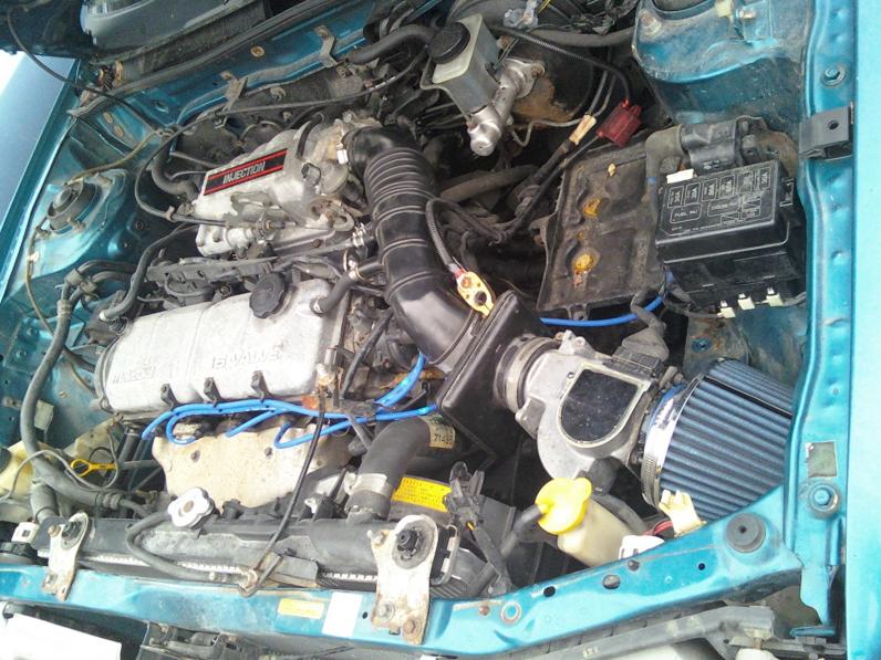

I finally Found out how to install a cold air filter on my car. cant use the tubing, but the air filter gets mounted to a bracket that bolts to the mass air sensor. I just made a bracket and installed it with the air filter, sounds great car runs smoother too. Ive attached a picture of mine and a picture I found from another car! so you can see how it looks in the engine compartment!
Anyone that wants to know how to make the bracket msg me and I'll tell you what I used!
