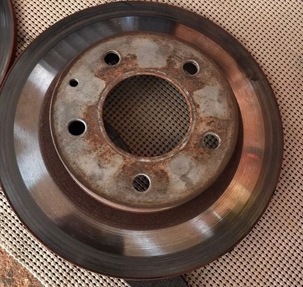

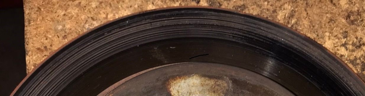

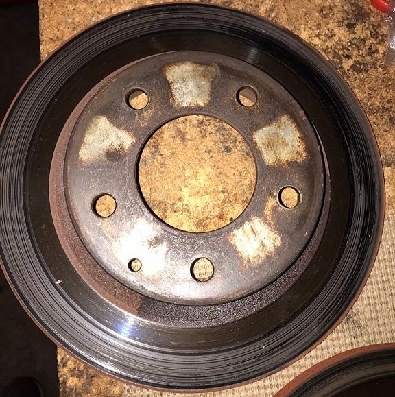

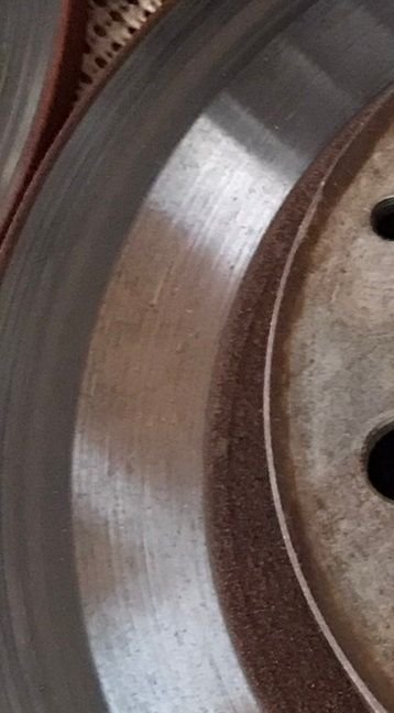

Now for a closer look at the old parts. You can see the scoring on the outer half of the rotor's surface. Driver's side was pretty deep. Passenger side was better but would still catch on my nail as I swept across.

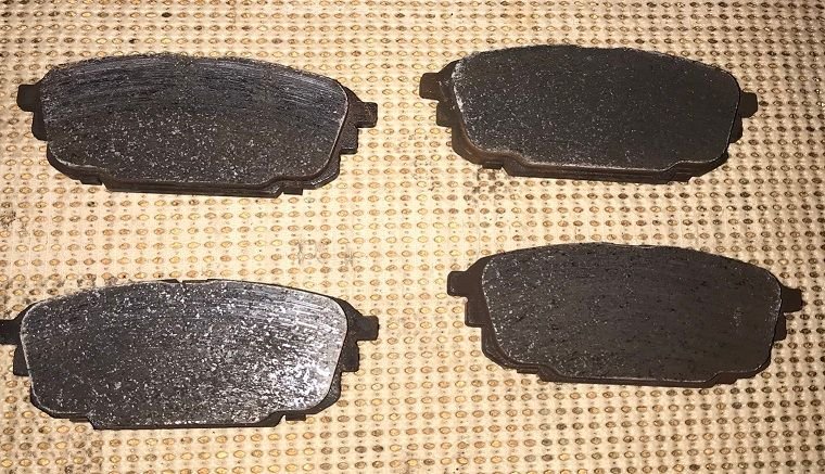

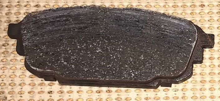

The pads still have plenty of material but, there are cracks in the pad material. The pads on the left are the outers. It's hard to see in the pics (sorry!) but you can see the grooving and if you look hard enough, you may see the radial cracks starting around the center of the pad to the outer edge.
Driver side rotor
Passenger Side Rotor
Brake pads (outer on left, driver side on top)
Closeup of driver side outer pad.
Closeup of rotor section (driver side, outer).
Closeup of Passenger side rotor.
