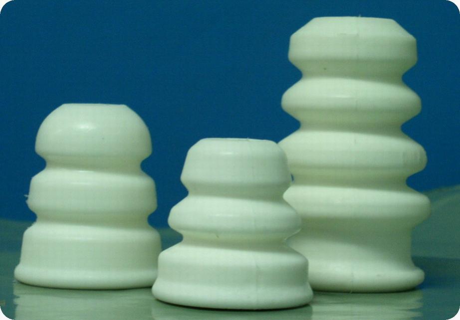

hi guys i looked at both of my front struts carefully it appears to be missing the jounce bumpers on both sides, if these are missing will this cause vibrations and clunking over bumps?
here is a picture of the part am talking about:

pic of jounce bumper .
