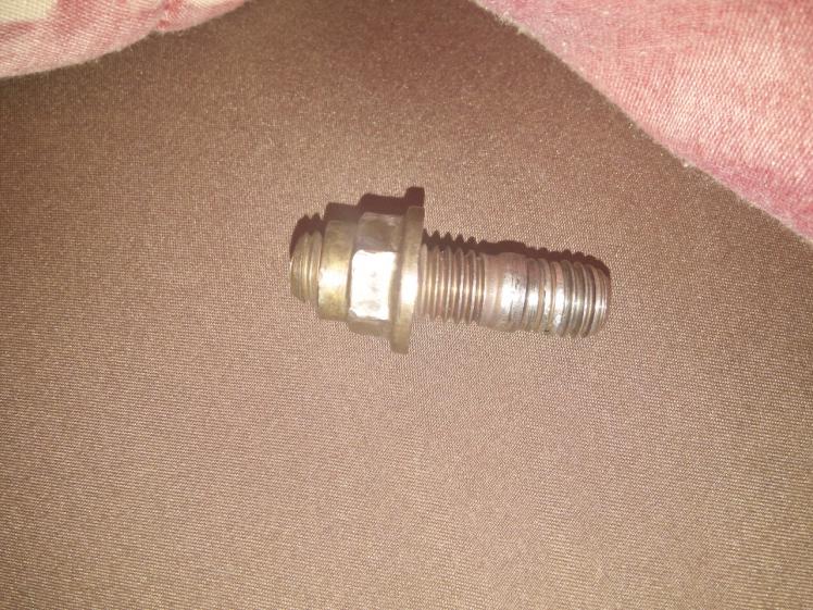

Broke some studs on bottom of catalyic converter. Got the replacement studs, but i need help finding out what kind of nuts these are. (See attached pic) Will I be able to use the regular hex flange nuts to replace the ones I broke?

Those are self locking, not really re-useable. Just use regular nuts with lock washers.
