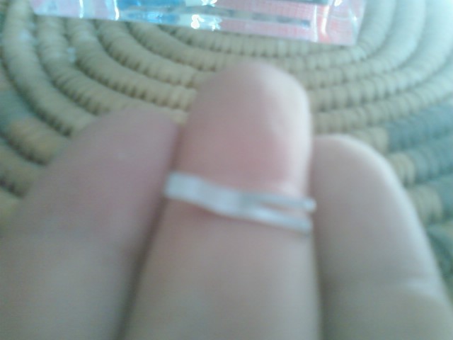

i bent the tab, worked great for a few days, now its doing it again. i tried bending the tab a bit in both directions and neither helped. i can see that when i shift it into park it just barely touches the tab. i can put a tiny screwdriver in and push the tab down(into column) and get the key out whether i'm in park or not, but the tab isn't quite long enough to get under the tooth on the shifter that looks like it should be pushing the tab down. ...any suggestions?
Old Oct 13, 2010 | 06:01 PM
  #75
momsMPV's Avatar
Joined: Oct 2010
Default oops....loose tab
so i tried bending it again, and the whole tab came out....it didn't break, just came out....any ideas how to put it back???
