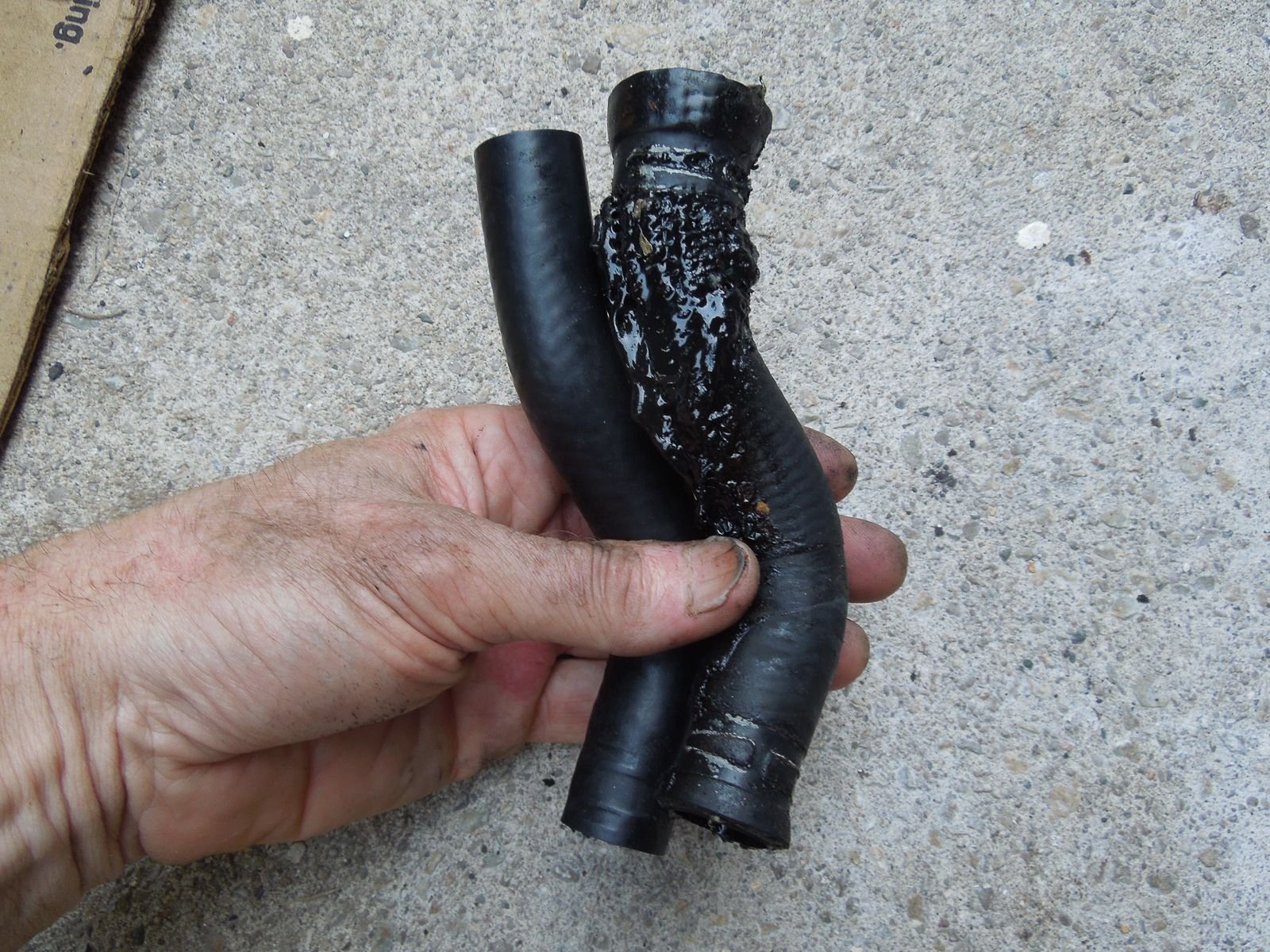

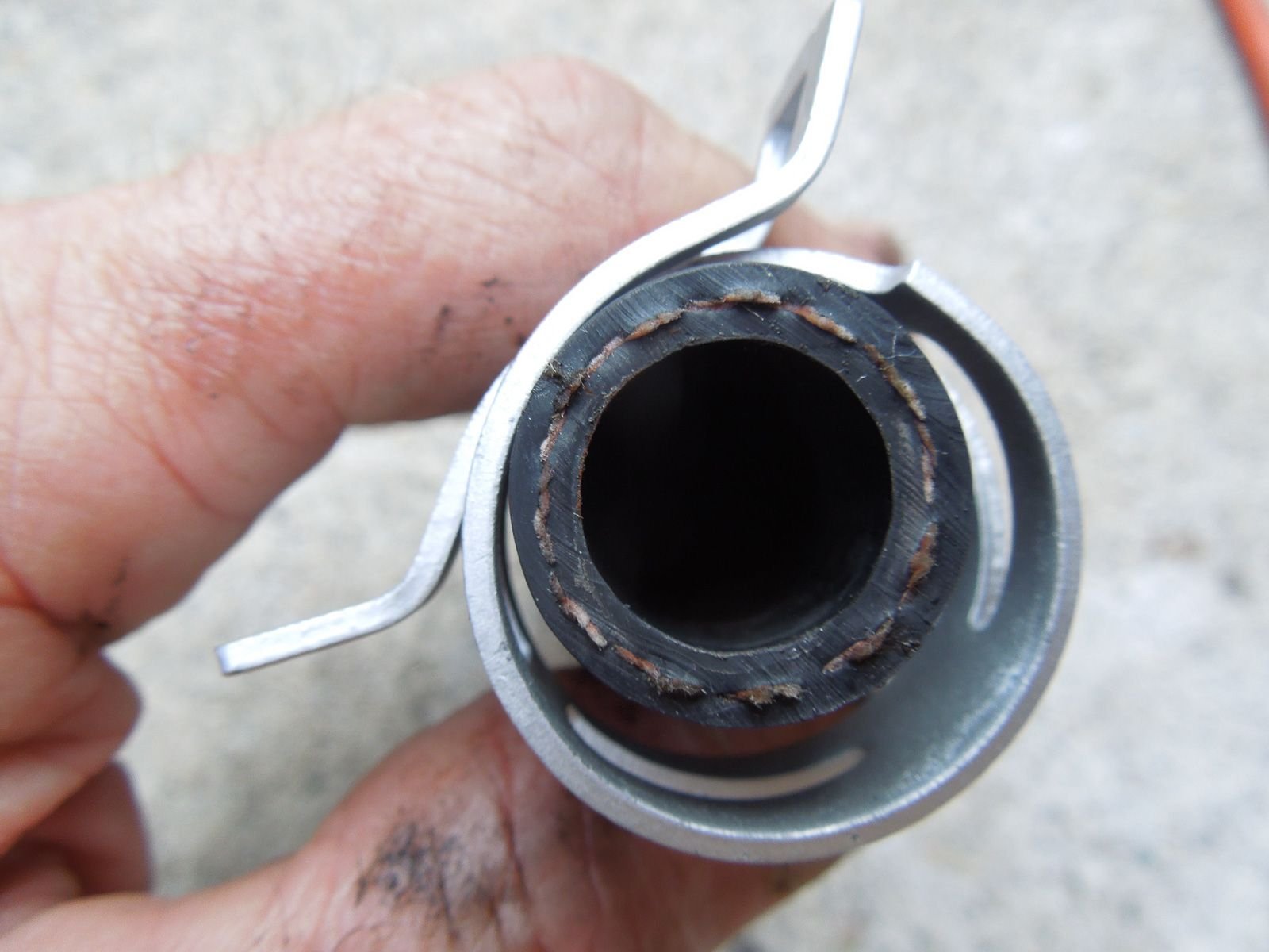

Well, I'm not too happy right now. I got the new Dorman part and it cost about $150CAD. I was kind of confused when I was looking at it because it came with one large hose clamp in a separate ziplock bag that didn't fit anything on the hose assembly, but I figure it might make sense later or maybe it was for a different vehicle, since this part fits some Fords too. I drained the coolant and started removing the old hoses. I got the leaking hose off the bottom of the water pump and realized that the top of the hose was larger than the bottom. I check the waterpump outlet and it is 3/4" or 19mm and the metal tube that the bottom of the hose connects to is 15mm or about 5/8". The larger hose clamp that came with assembly is also about the same size as the old clamp that came off the waterpump outlet. The new hoses on the assembly are all the same size on both ends, about 15mm I.D.

The new hose beside the old one.
new hose on left and old on right. Big difference in the size.
Hose clamp that came with assembly doesnt fit new hose.
Hose clamp that came with assembly doesn't fit new hose.
