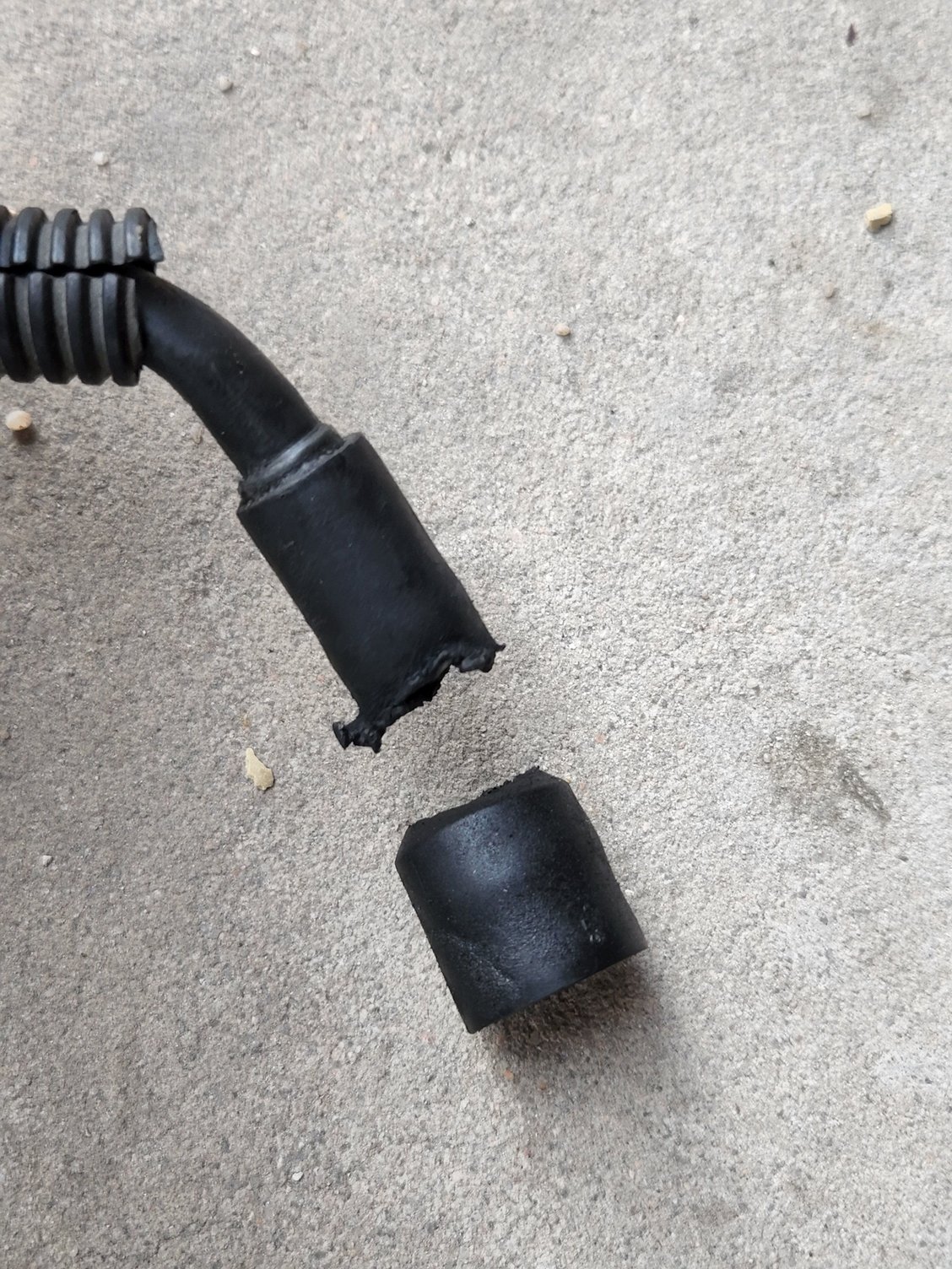

Hello all,
Can someone help me identify this vacuum line? I was replacing the water hoses and connectors and managed to pull this off and not sure where it goes to. I've found two vacuum diagrams but doesn't say what it is or where it goes to. Any help appreciated!

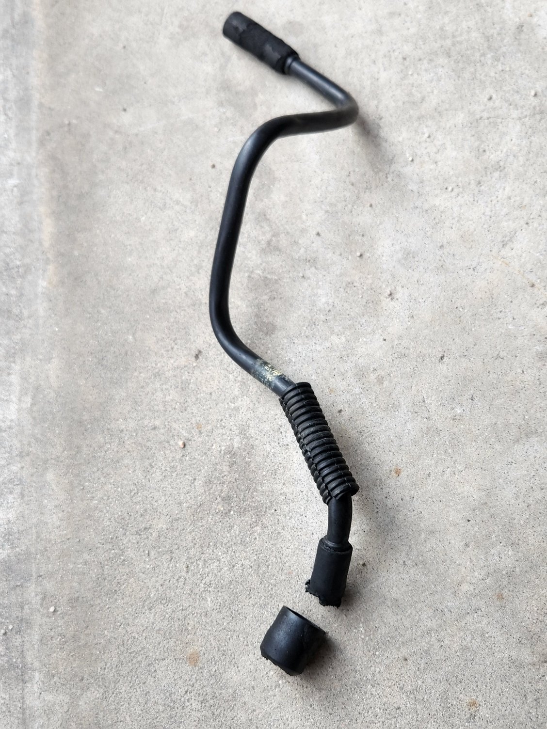

Replying to my own post here just to close it out and mark it solved. Here's the vacuum hose after I pulled it out and apparently after a lucky google search I found what I was looking for. This is called a breather hose and what's pictures is the half closer to the firewall.
