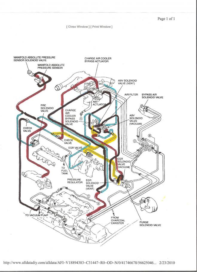

Just had problems with vacum leaks....Here is a diagram of vacumn lines for 2.3 Millenia hope it can be of assistance
