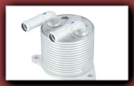

This is a must have you should have in your tool box!
MiniTemp MT4 Automotive Handheld Thermometer RTK-MT4

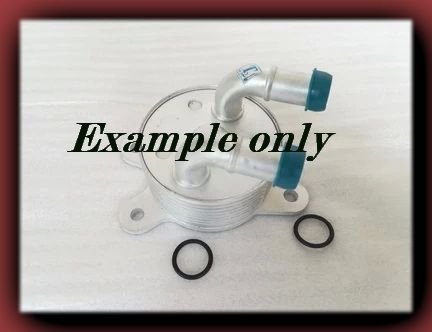

As for *coolant style automatic transmission coolers most have only 2 rubber o-rings that seal the transmission fluid only that could if the integrity of the cooler (corrosion or internally damaged) can leak oil into the transmission fluid if the failing conditions are right.
These type are design for 2 jobs, to help regulate the transmission fluid temperature to the same as the coolant and to help during cold starts to heat up the transmission fluid to operating engine oil temperatures.

As for the cooler you can replace my transmission fluid and transmission info with engine, and it is the same. Basically, if the core corrodes or is damaged it can leak into the coolant. Sorry about the confusion but there are more failed or damaged transmission coolers then engine oil coolers so that how I posted the information. However, as I said they are the same type of coolers.
oil cooler type ... notice the similarities in the transmission cooler I posted earlier?
I do replace twice as many factory transmission cooler vs oil coolers.
