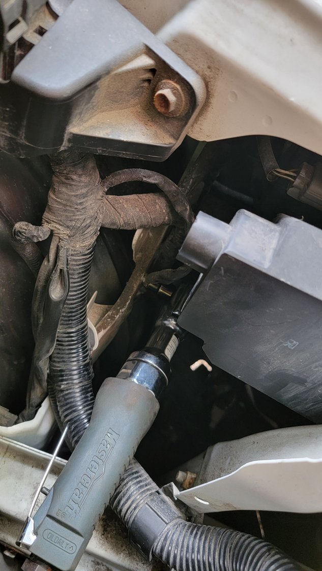

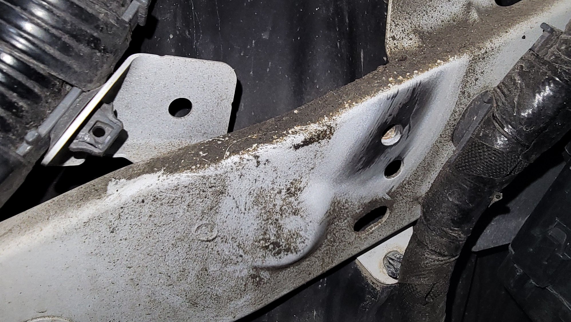

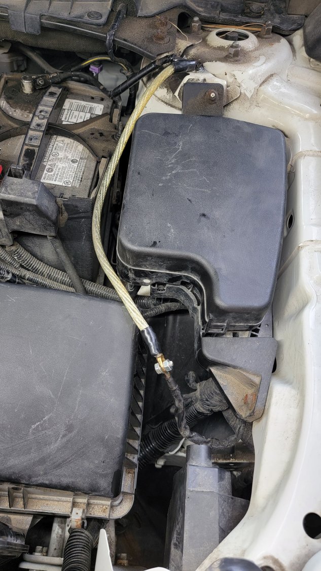

I just wanted to chime in here as I was just about to pull my hair out, and give Mazda some more of my hard earned money for such a ridiculously easy fix BUT hard to find issue!! Started with A/C blowing warm air on a trip back from camping. Followed up with a trip to Mazda to confirm, condensor had a hole it it. Mazda did not mention my fan wasnt working atthis time. Replaced the consensor myself for $250 CAD. After this i noticed the fan wasnt working. Found voltage going to fan, so figured fan motor was bad, replaced it, still didnt work.. after a few days of checking thermostat, coolant temperature sensor, buffing ground contact points around the engine bay.. found a BAD GROUND on the radiator/condensor cooling fan, which I believe took out my A/C air conditioner condensor (hole in the line likely from overheating/overpressurization). Rewired the cooling fan ground to a SOLID known good ground, and it works again! Note that just taking the old ground off and buffing the metal WAS NOT ENOUGH! See pictures for location of BAD ground (right behind driver side headlight), and how I wired the new good ground (still needs to be routed pretty, but works!) Hopefully this helps some other people!

While you are at it you should add a couple of ground to engine and ground to other chasiss point. As well I highly recommend to install an addition positive cable from the battery to the starter.
Next time disconnect the fans and jump them directly to test their function.
In a pinch you could have left them disconnect and ran a couple of lkeads grounding them and powering them for the long drive. PIA to pop the hood each stop and disconnecting the ground to shut off the fan but at least you would have them running. The AC on some system will not function if the fans are not running.
